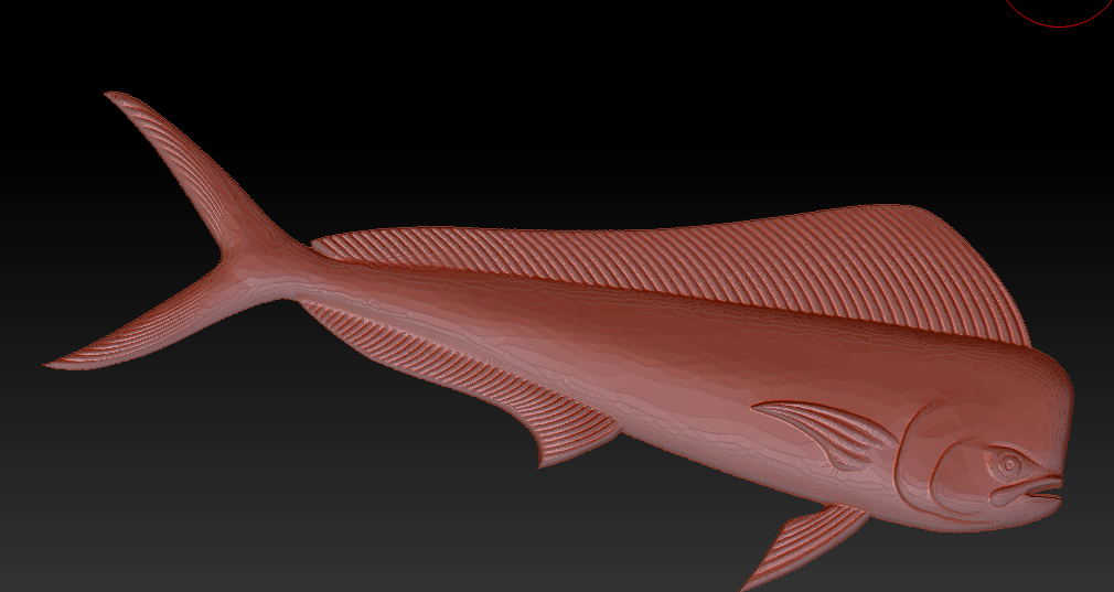

I have a fish that is hollow on one side and I wanted to make the hollow side closed making the fish solid.

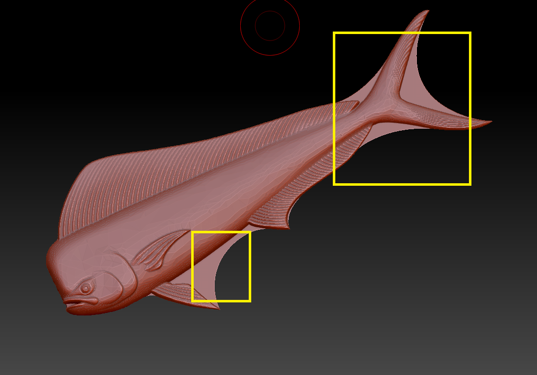

Unfortunately, the “Close Holes” command creates some extra geometry you can see in the yellow boxes.
Is there a cleaner way to close the holes without changing any of the outline of the fish?
Thanks for any advice.
You can use ZModeler. In the Edge options select Close and Concave Hole then click on one of the outer edges.
Thank you. I will try that. I was going to just try and see if those newly creded meshes were there own polygroups and delete them but the mesh is too dense and I think the whole model is still just one polygroup. So your way sounds better.
I’ll report how it goes, thank you.!
It worked perfectly!
Thank you so much. I really really appreciate how you answer questions on this forum. I can’t thank you enough!
