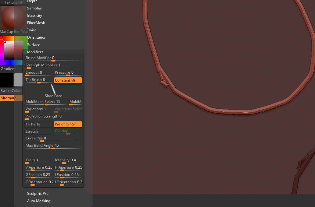

hi How do you close curve IMM brush properly?
I turned off triparts option off, but sometimes the curve start and end dont welded nicely.
Hello @katosaori ,
The mesh geometry must be open ended and the points must align perfectly on either end when the mesh repeats.
Additionally the mesh segment should not be too long. I can’t be certain but it appears as if your curve may be made up of long thin sections. This will impact how easily the stroke can wrap around a curved surface or bend to follow a curve. Try to create the repeating segment out of the minimum length of geometry you need to repeat the shape. Try not to use a long rectangular box if a simple cube will work.
Ex: A chain made of of small, short segments can easily change directions and follow any curve. A chain made up of golf clubs attached end to end would have difficulty following strong curves and it may be difficult to get the ends to align.
@Spyndel thank you very much for the answer.
I will make objects segment length longer and open ended.
