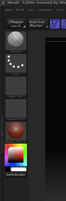

I’m creating a new menu to house a specific set of brushes. How can I change the size of the icons for those brushes within that menu?
On a related note, I’d like to use smaller icons for the left tray items like Brush, Alpha, Texture, Color… How can I reduce the width of those items. I’ve seen UIs that use what seem to be half-width icons instead of the huge gigantic ones.

Thank you. But I should have been clearer. My fault. I’m aware of those settings. What I was wondering was how to shrink them even further, as is the case in one of the alternate layouts that ship with ZB.
For example in the images below, the first one is the result of unchecking Wide Buttons and moving the above slider to the lowest setting of 38. The second image is from an alternate layout that reduces them even further.
I can create my own menus easily enough, but configuring icons to be that small still eludes me.
Apologies for not being clear the first time. Doh!
That sample that you show is done with Wide Buttons turned off. Then if you open the Texture, Stroke and Material palettes you’ll see small thumbnails next to the large thumbnail.
For example, in the Texture palette you’ll see a large square with four 1/4 sized squares next to it. The upper left of those is the No Texture thumbnail. Move that onto the shelf, where it then acts just like the large thumbnail. Same goes with the default stroke, alpha and material icons.
