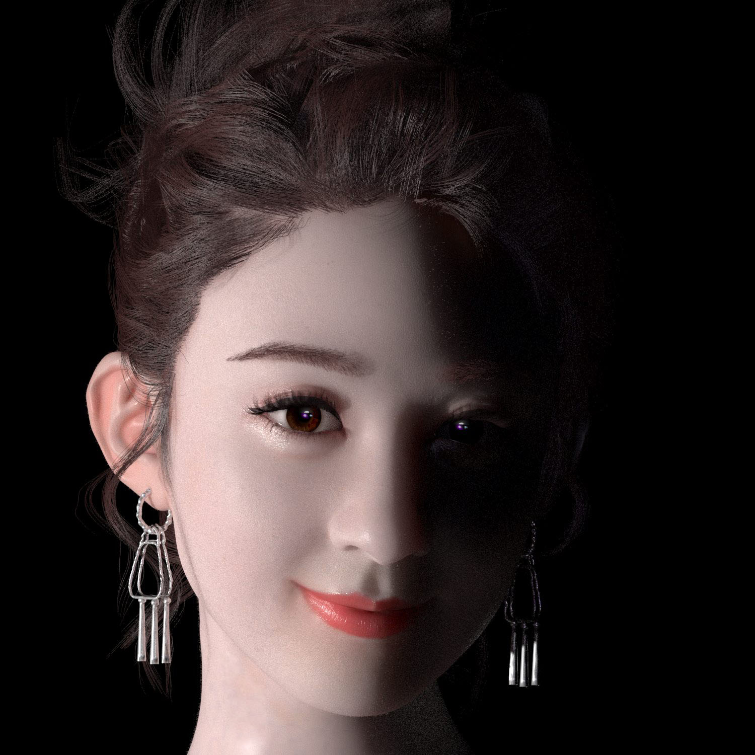

Challenge of Ultimate Accuracy-Simulating Zhao Liying

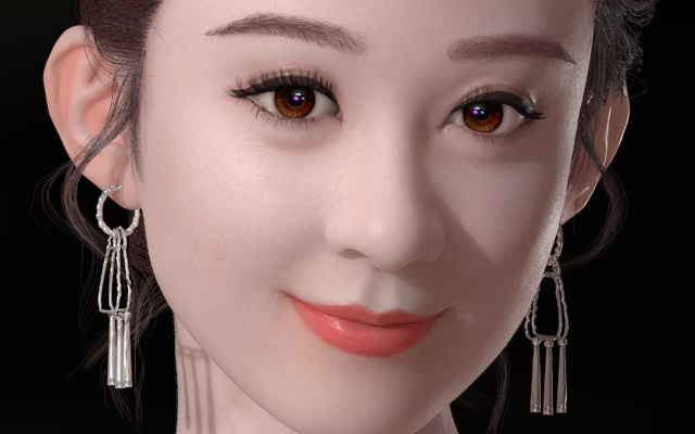

Making materials of Zhao Liying. We will make this 4K texture from scratch, which includes four basic/highlight/replacement/sss maps as a whole, because the star’s skin is very good. We did not intentionally increase the effect of chloasma, which would destroy a lot of aesthetic feeling.
Surface texture
Previous drawings are very fast. We made a superfine texture of skin through Substance Designer. There are many hand-painted blood vessels. Various changes have been made before and after. The deep and surface texture can be enlarged infinitely through the powerful display function of Substance Designer. Texture has been revised for 49 editions.

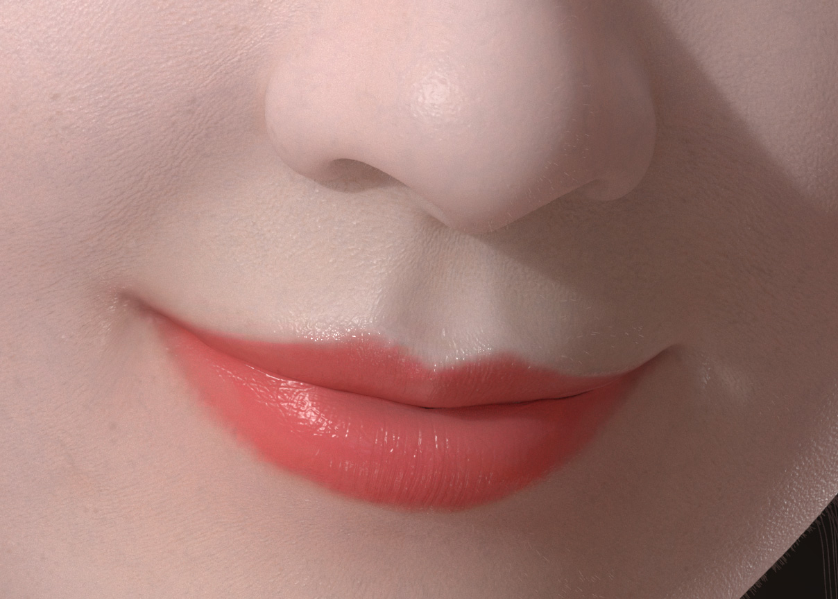

High gloss material
By replacing the map, we can easily get the texture of high light, where there is no highlight, and then the part of the lip and eye shadow is controlled. The adjustment work has been done for a long time, and we revised it 27 times in the last edition.

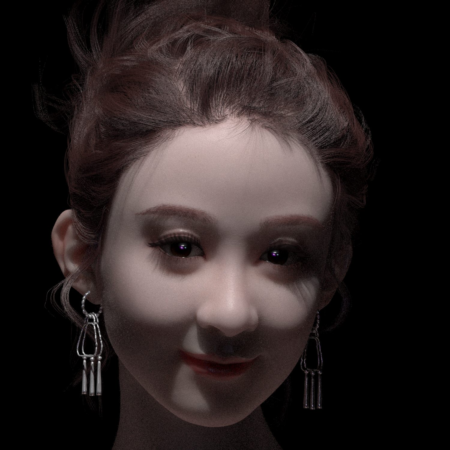

SSS material
This is the simplest texture, through Substance Painter calculation, we can get a good volume structure, such as the thinnest ears, nose and lips have SSS effect. If we control the SSS parameters, we will get a good SSS effect. We only made 4 versions of SSS maps.

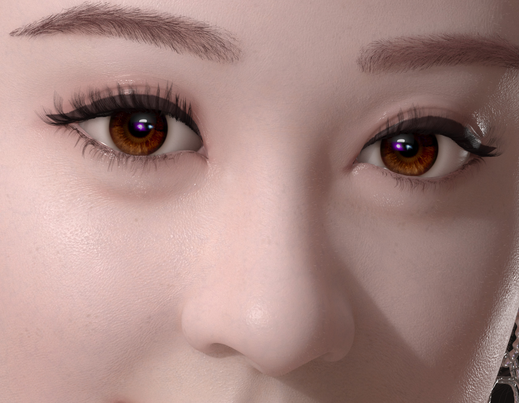

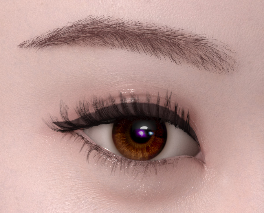

Eyeball Material
The modification of 39 edition eyeball material has created the real eyeball feeling. This eye should be the most place to do. A little problem will bring untrue phenomena. We control the relationship between white and black eyeballs and lens. Here we use a unique method to separate black and white eyeballs, and the lens and white eyeballs are connected together. Good results have come. I strongly recommend that you also use this method.

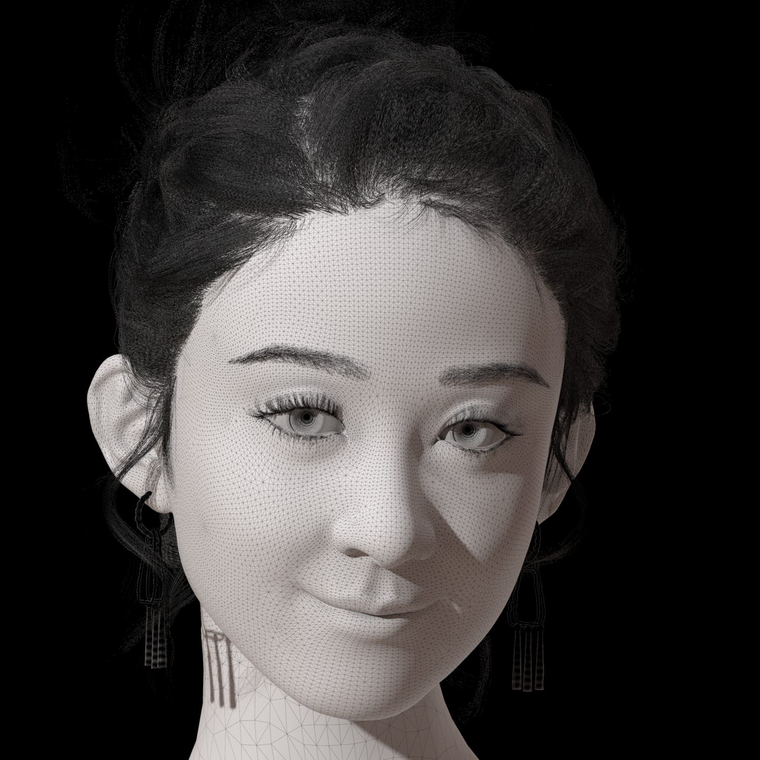

On Polygons
The polygon in the figure below is the final polygon. Although many of them are not difficult to adjust, we can import these transformations through the ZBrush layer and adjust the expression for minutes. So high polygons are the current standard.

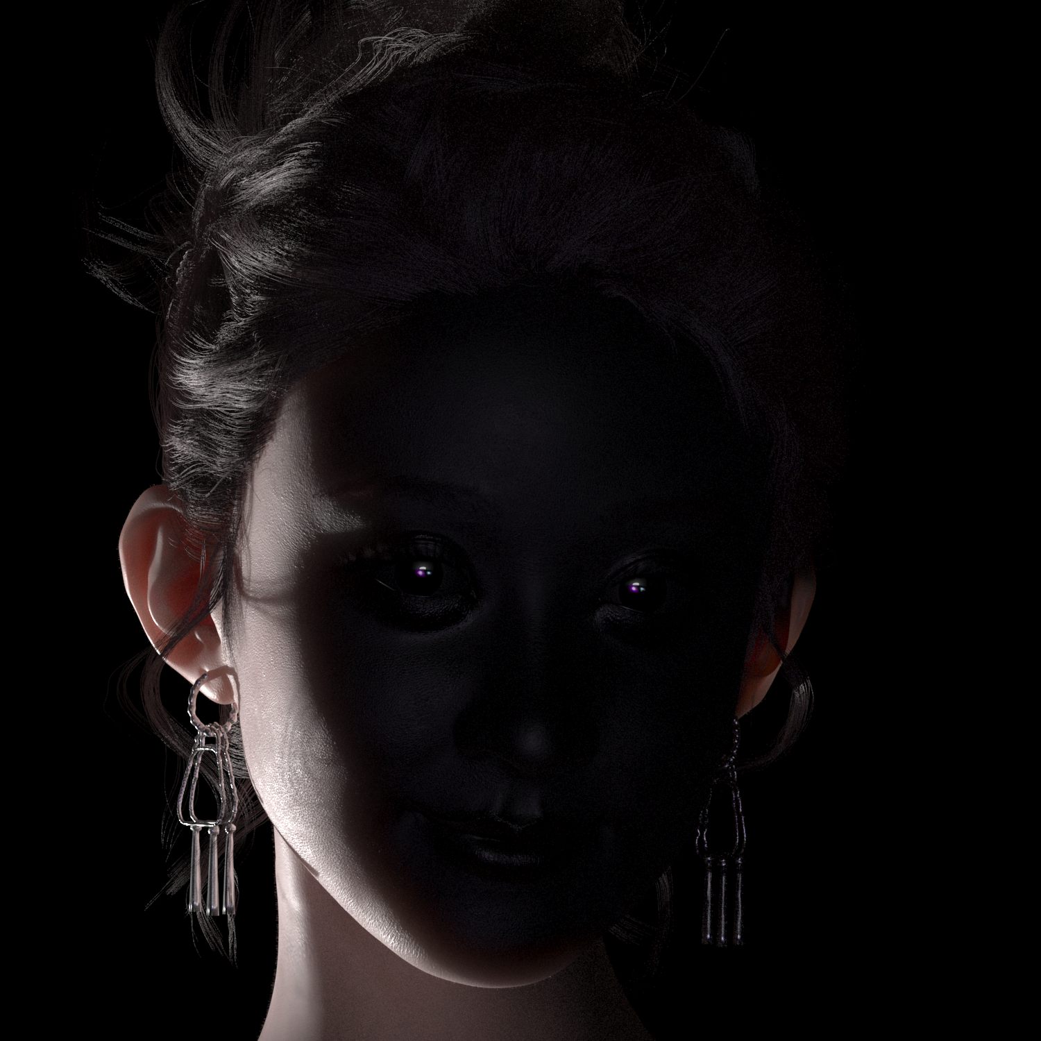

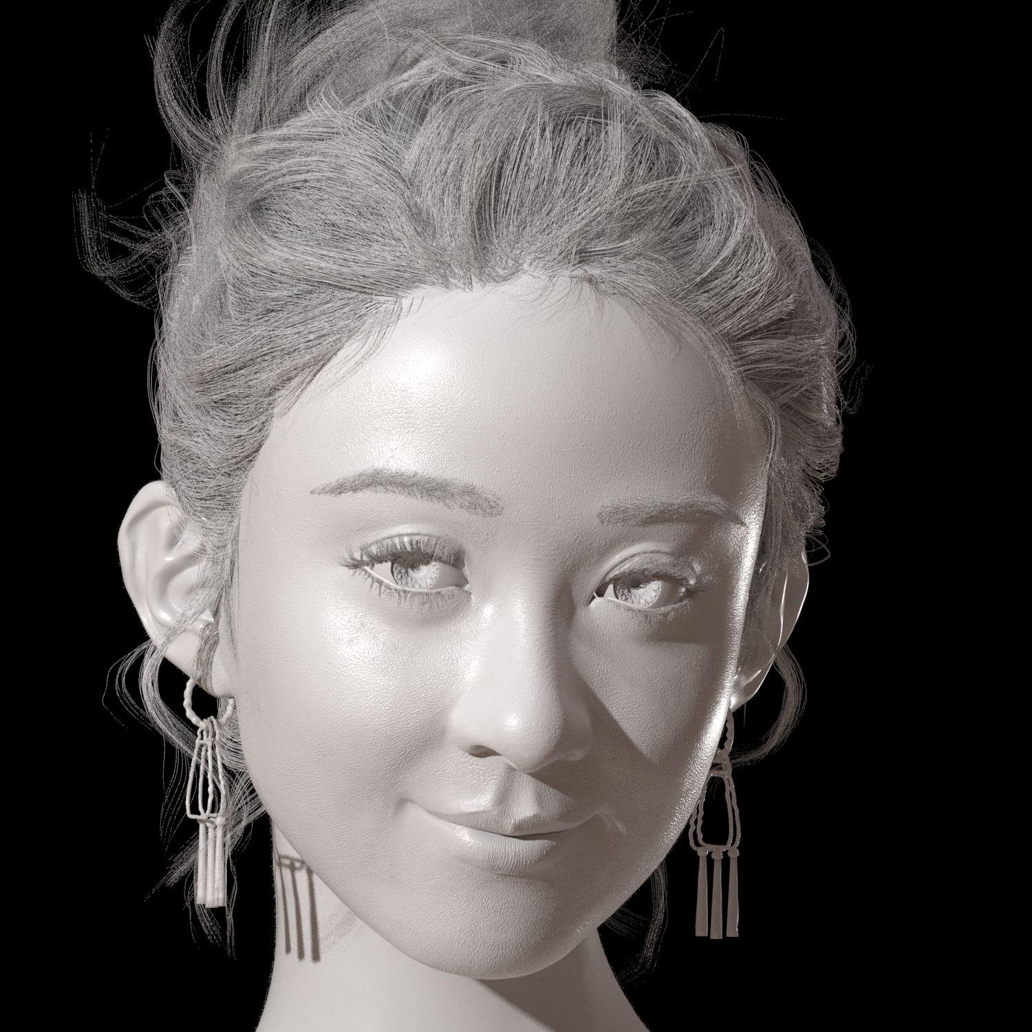

About polishing
We used an HDR map as the ambient color, and then hit the main light / backlight / top light / reflector respectively. Lights are large circular light panels, which will project a more realistic sense of shadows and light.

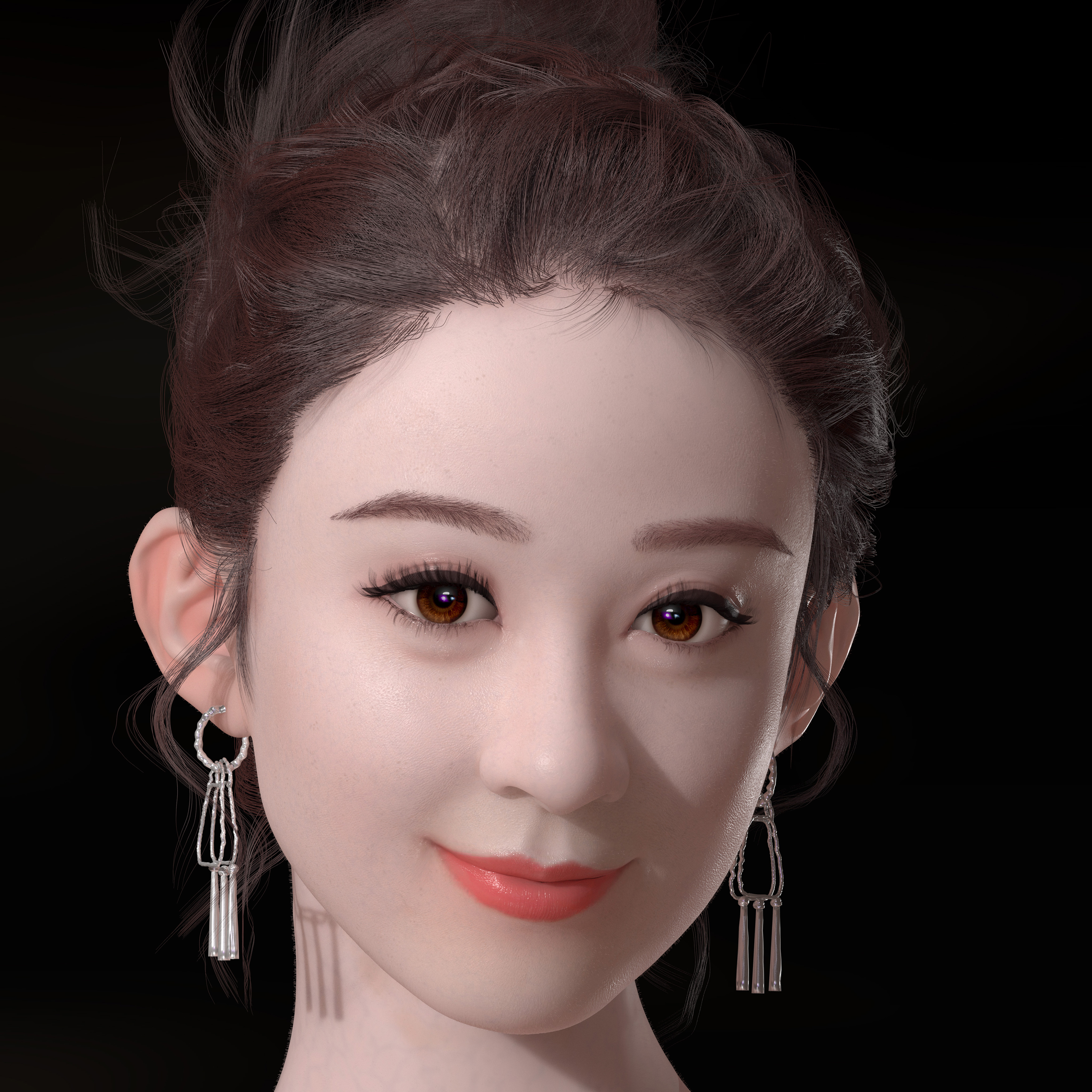

On Rendering
With Arnold 6 level rendering, 4 K rendering lasted about 10 hours, compared with the time spent on hair rendering speed. Arnold’s grade increases exponentially. Level 3 is the default. Generally, there is no obvious mosaic.
