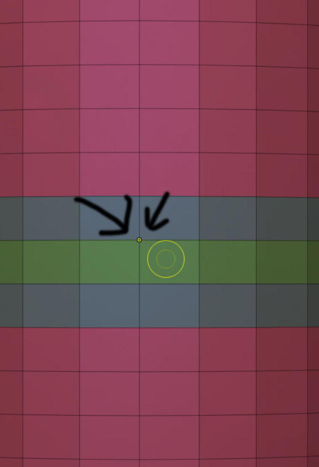

Cant select middle face Polygroup because the brush locks to vertices?
Not sure if I pressed something but I cannot select the middle polygroup to hide or isolate it. I noticed the brush radius locks to vertices and I cant select the face, is this normal? I don’t remember that happening before. Either way I cant select the middle polygroup anyone know why?

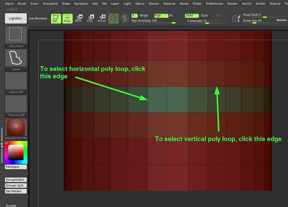

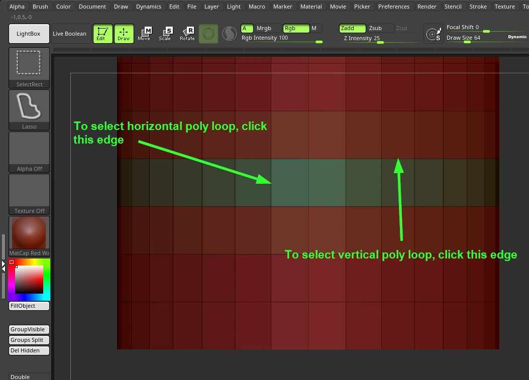

If your not using ZModeler, then that is normal. It will only snap to vertices and the one vertice is using 2 polygroups. However, you can use the Lasso stroke with a selection brush and click on the appropriate edge to select it (see image).

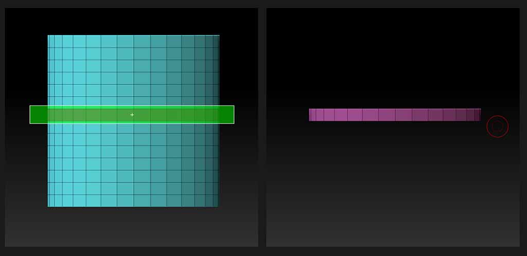

As ZBer2 explained, ZBrush thinks in terms of points, not polygons in most situations. As another way to go in this scenario it would be a simple matter to select this with the default selection marquee, by simply drawing out a selection marquee that contains all the points of the target selection, but does not contain all 4 points of the adjacent polygons:
If using ZModeler, you can also use the Transpose action set to the appropriate target to instantly mask all but the target selection.

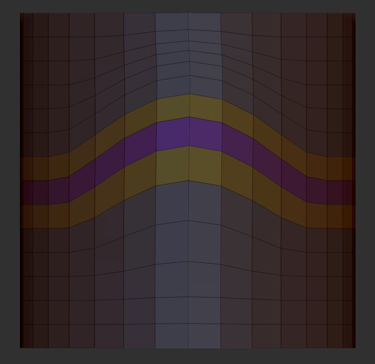

Unless you have a situation as in the following image, in which case the method I described using the Lasso stroke would be more suitable. :slightly_smiling_face:

If the shape is odd or not a polyloop, then just do the PG isolation in two clicks without the need to change to a lasso stroke. First click on the vertex that adjoins green and blue PGs as you have shown. It will pick them both and hide the rest. Then click on a vertex on the outer edge of the blue PG that doesn’t touch the green PG. It will hide the blue PG leaving only the green PG.
