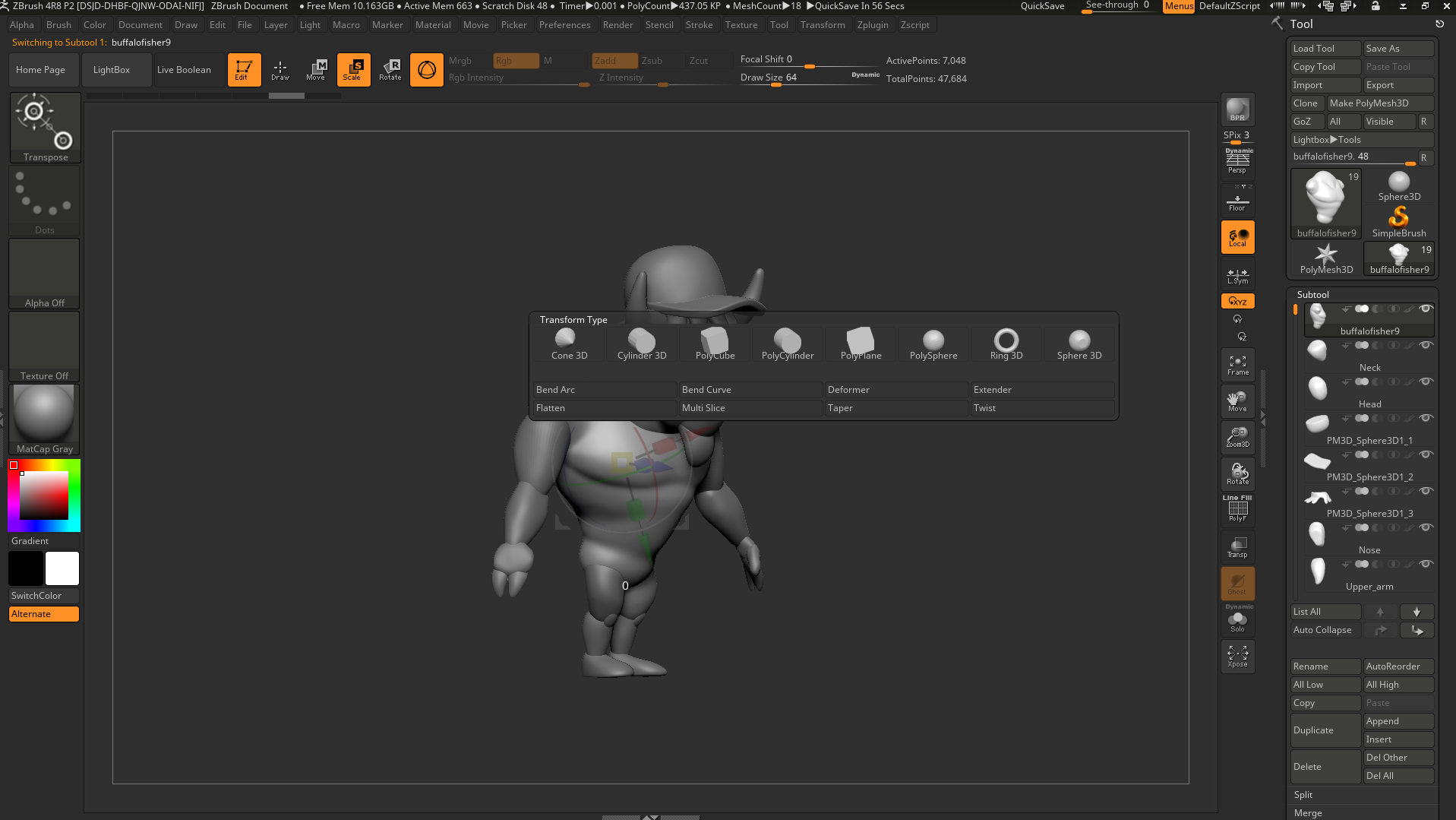

Can't figure out why Gizmo's entire customize menu won't open
I don’t understand why it won’t show up? This is my first time learning how to use the Gizmo tool properly and I’m trying to follow some videos on how to use the customize menu, but it’s not showing up entirely. (Trying to use remesh by union.) Any ideas what’s going on? It’s driving me nuts. Thanks!
You’re on ZBrush 4R8. You need to upgrade to 2018.1, which is free to registered users.
Thanks! I tried to upgrade it last night using the updater but it said I was up to date. I’ll try again, maybe I did it wrong!
You can’t use the updater. You need to follow the instructions here:
https://support.pixologic.com/Knowledgebase/Article/View/231/64/upgrading-from-zbrush-4-or-above-single-user-and-volume-licenses
Thank you so much, I was able to figure it out thanks to your tip! Much appreciated
