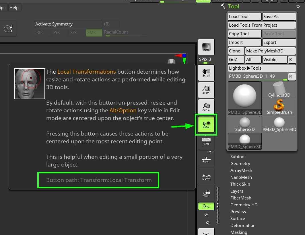

Make sure you have “Local Transformations” turned on.
Hello Zber2 it worked perfect!!! I had no local transformations in sight and when I found it it was off, thank you very much.
