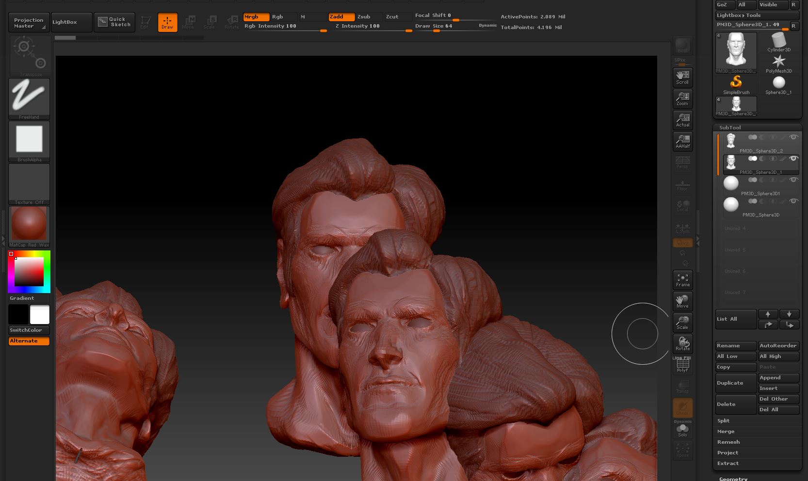

Hello,
I just started using ZBrush, and the sculpt I’ve been working on has encountered a problem that I am unsure how to fix. I used the move tool to adjust the placement of an eye, but after I did that, I couldn’t get out of the transpose brush, and I can’t get into edit mode. In addition, my file is now filled with copies of my head sculpt.
If this is a major issue, I can just load back a pretty recent former save. I mostly just want to know what is causing this problem so I can avoid do that in the future.
Any advice on this issue would be greatly appreciated!
It looks like you’ve been dropping out of Edit mode, making snapshots of the model on the canvas.
Just press Ctrl+N to clear the screen. Draw the model again. Press T to enter Edit mode and return to sculpting. Then avoid pressing T in the future or you’ll exit Edit mode.
Thank you, aurick! That totally fixed it!
