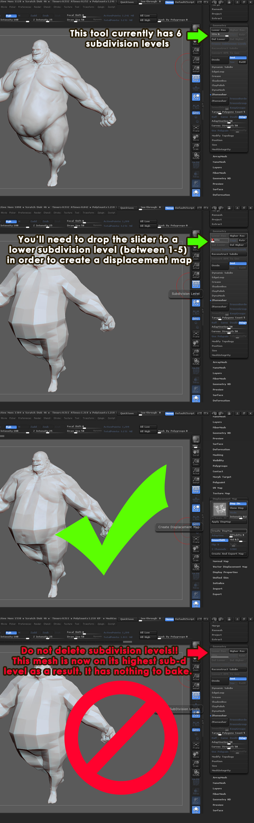

You don’t want to delete subdivisions or even freeze them. You NEED higher subdivision levels in order to create normal/displacement maps, otherwise there would be no information to displace and you’d just wind up with a blank map.
What you want to do is drop down to a lower subdivision level (either use Tool: Geometry: SDiv slider, or Shift+D). Then the displacement/normal map created will contain the differences between this active level and the highest one.
  • For polypaint color maps, you’ll want to create the map on the highest level in order to capture all the vertice color information.
  • For Displacement/Normal maps, you’ll want to create it on a lower level in order to capture the difference in detail
Other operations might generate a similar message if they alter the topology of the mesh by either adding or removing vertices. In these instances you’ll want to either delete the higher/lower levels, or freeze them (freezing will temporarily delete the subdivision levels, and upon unfreezing will try to project the old detail onto the new topology)

Once again, DO NOT REMOVE SUBDIVISIONS. If you have no subdivisions on the mesh then there is no detail to bake to those maps; you might as well just create a pure gray or blue texture map in that case. You are getting this error message because you are on the highest subdivision level as a result of removing the rest. To put it another way: a model that has no subdivision levels is considered to be on its highest subdivision level. You need to have higher subdivisions present (but not active) in order to bake.
Instead of removing the subdivisions, just step down through them and then bake.
