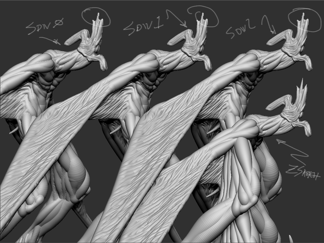

here is a quick test of the unified skin at some very high settings. no matter how high i go at this point i can’t seem to capture the head details. it looks like ill have to simplify that face layout and try some more. love the Zskiffs.

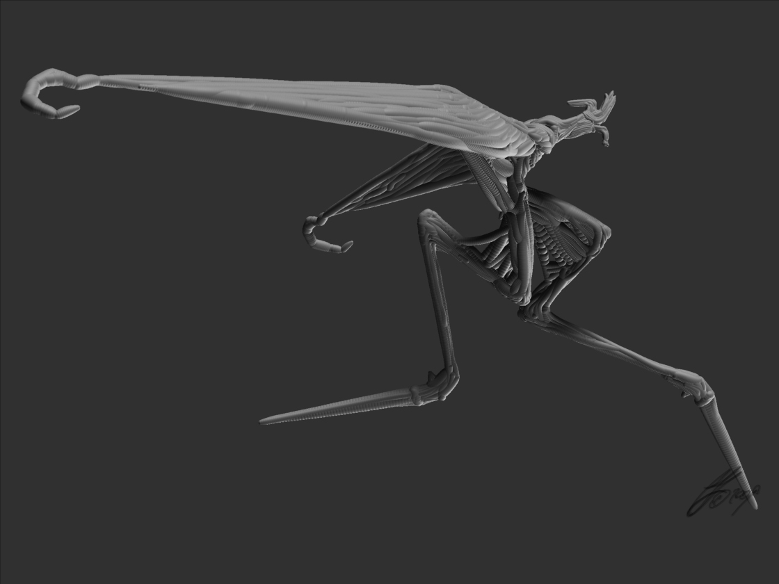

Well this has been a fun test. Its so fast to create with ZII’s. here is a quick pose and render of the ZSkiff SandSkimmer. I optimized before posing and should have rebound things first. However, nothing that can’t be fixed, or quickly redone.

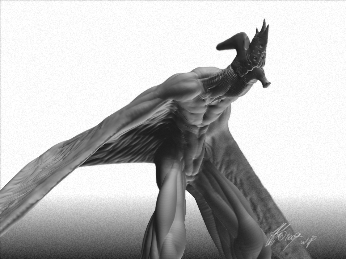

I laid down alot of spheres to creat the muscles its a little too messy. Im going to redo this one with larger and fewer spheres to get a nice clean unified skin.
Changed the zpheres around some. Cleaned up the the body and gave the wings and head another try. Not capturing 100% of the smallest spheres in the head but the wings and all that wrinkly detail came through on the wings. Will make a skin of this and start sculpting it next.

That’s one thing I noticed with these new ZSpheres2 is that posing after laying them out (even after rebinding them) deforms the some of the ZSpheres but not all the connecting ones, even with softness set to 100. And as you say, they can be fixed after posing. But that’s one thing I hope Pixo addresses at some point.

KrakenCMT, thanks, im with you, this is a great new tool, im sure it will be looked after. Ive put her in a basic pose and made a good skin. i’ll get her a little closer to finished and adress the head forms that were not captured. then retopo to take here all the way.
Quick pic of the unified skin with a few minutes of tweeking the face. I think what I like the most about this new aproach to spheres is how close it can get you right off the start. Which ever skinning method you go with, reducing the amount of inflations breaking the mesh, and reducing the amount of sub divisions needed to get all that form is great! It means Im adding the smaller forms and details sooner in my work flow, having attacked the bones and meat of the sculpt with the spheres. This model has 1 million polys at sdiv1 and it hold up well for this little render. More to come.

hey thanks support for the tips. That is essensually what I have done. Im getting great results with the exception of the horn tips. When skinning, it creates webing between the tips, and some in the mouth. everything else is Superb!
