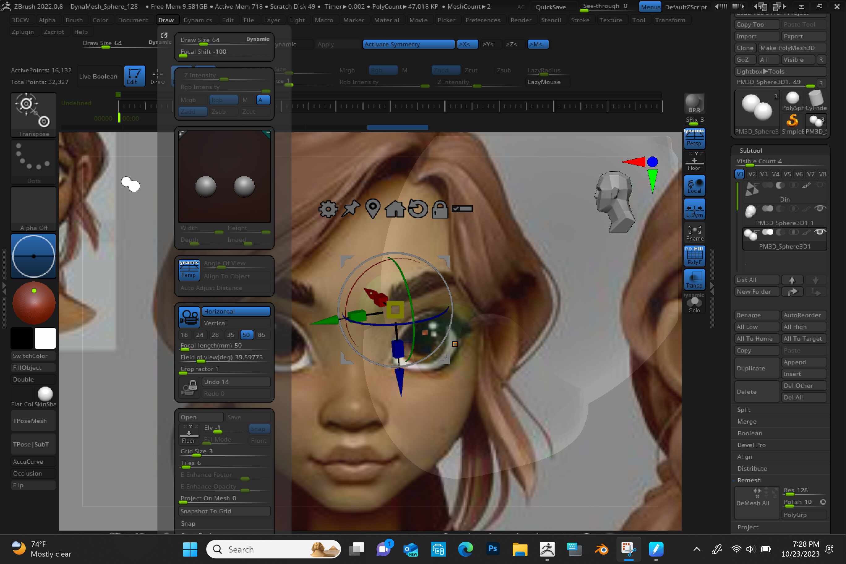

My camera doesn’t work. I click store camera and it doesn’t respond I am not asked to create a name I looked online for solutions to that problem and found one that told me to use the timeliness. It says go to movie>timline>show and it shows the timeliness but on the video it shows where it says “camera” on the timeline, is to show what is being animated. Where it says “camera” on the video, mine says “undefined” and it’s grayed out

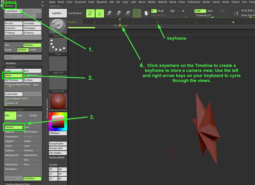

I don’t know why your “Store Cam” in “Draw” palette doesn’t work. I’m on version 2022.0.8 and mine works. You can however store views using the Timeline (see image below).
No, that doesn’t work for me. I think it’s the same problem why neither method works. You see at the start of the timeline on your image where it says “camera”? On my image it says “undefined” there
@bigguyonwheels It will show “undefined” until you click on the Timeline to create a keyframe. Once you create a keyframe, it will say Camera.
