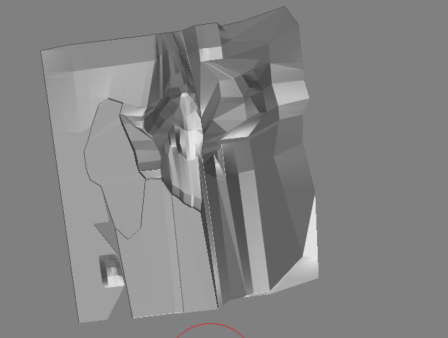

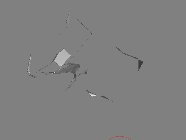

Hi There,
Here are jpegs showing the top and bottom views…I tried placing the object in rotate view and clicking and dragging outside of object, but no luck…any advice is greatly appreciated :cool:
The following will make the polygons visible from both sides.
You should try toggling the “Double” switch in the Tool menu under Display Properties.
It may be that the normals are flipped when you’re importing from Maya, use the Tool.Display Properties.Flip switch if this is the case
Hope that helps.
Edit: removed suggestion that surface normals could be flipped on import via a preferences option.
OK, I think that if (with your object in Edit or Transform mode) you press the Tool>Display Properties>Double button things should be all right.
