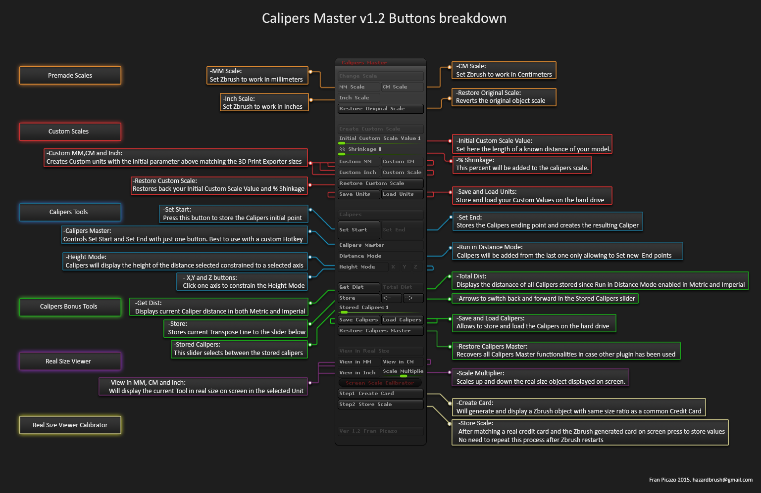

Here it is the first release of the new Calipers Master Zplugin. An alternative way to measure inside Zbrush using Transpose Lines.
With this plugin you can set up a scene to work in Millimeters for 3D printing and check measurements accurately such as wall thickness but also you can use it to set a custom scale to work with proportions.
Just set a starting and ending points and Calipers Master will generate the resulting Caliper in the selected Units
Also Run In Distance Mode feature included to keep adding transpose lines along a path accumulating the Total distance traveled. Usefull for aproximate a curved measurements and posed characters.
List of Features Included:
-MM Scale: Set Scene to work in real world Millimeters
-Create Scale: Create a custom Scale such as Heads
-Restore Scale: Always can restore back to original modelling scale
-Set Start: Set starting point for the Caliper
-Set End: Set Ending point for the Caliper
-Calipers Master: One single hotkey to control Set Start and End
-Run In Distance Mode: Create Calipers sequentially from last ending Caliper and stores the accumulated distance
-Get Dist: To Display current Caliper measurement in scale Units
-Total Dist: Display the accumulated distance while Run In distance mode
-Store: Able to Store any hand drawn transpose Line
-Stored Calipers Slider: Store up to 32 Calipers
-Back and Forward buttons: To navigate the Stored Calipers Slider
-More features to come!
