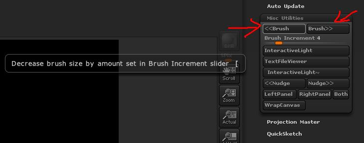

The Draw Size can already be adjusted using the bracket keys [ & ] and you can set the increment using the slider in the Zplugin>Misc Utilities sub-palette. For Focal Shift and Z Intensity you could try this plugin provided by Wyrdesigns:

hey Marcus i think i buggerd the bracket keys [ ] for Brush size, they seemed to be locked, any way to fix this. I was messing around with settings in the Misc Utilities and they wont shift sizes now with just using the bracket [ ] keys.
Do you remember what the settings were before you played with them? You didn’t overwrite the hotkeys somehow?
Not sure what you may have done. Do the buttons work when you press them? If so, you probably need to re-assign the hotkeys. Just Ctrl+Alt+click on a button and then press the relevant hotkey.
yea but the slider uses 2 keys which are brackets, how do u assign 2 hot keys for 1 button.
No, the actual adjustment is done using the two buttons above the slider.

Not sure what you’ve done. If you followed the instructions for the plugin then you can’t have removed the brush buttons as that isn’t in the same location. You did install it in the ZBrush 4R6\ZStartup\ZPlugs folder?
Might be simplest to reinstall ZBrush if you can’t find what’s wrong.
yea i did put it into the Zplugs folder. Funny thing is its now working sliders move but i tried assigning short cuts for Zinten with ctrl+alt+7 and ctrl+alt+8 and it doesnt work weird stuff going on lol
Ok i know what i did wrong for Zintens not to work. I used numpad keys to adjust the sliders which didn’t work. I changed them to the regular number keys and Zintens now works along with Brush size. Thanks for your help Marcus.
