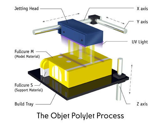

Hey Plakkie-
Here’s an image of how Objet’s Polyjet printing process fundamentally works. I’ll post a movie on our website soon for a better demonstration.

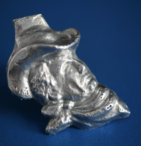

For my experiments the 3 and 4 axis cnc mill is fantastic. I mill my pattern into wood, then use that to make a form out of sand, then cast it in aluminium. When i don’t like the result, back into the scrap it goes and it will be remelted.
The amount of energy used to melt the aluminium is small. I use a camping propane gas tank for about 6-7 gallons of molten aluminium. That’s a lot of sessions… No waste. No plastics. And cool looking stuff.
Both are my first experiments at the time. Just to show what you can expect to get at the start of the learning curve. Since then my results exceed even my own expectations after a year of experiments. Just to show that you can really achieve great results for less than 3000$, safe, environmentally conscious, and still utilizing all the basics, backgrounds, and technologies involved with any rapid prototyping related technology. And maybe make that repair part for that cool 50’s toaster…

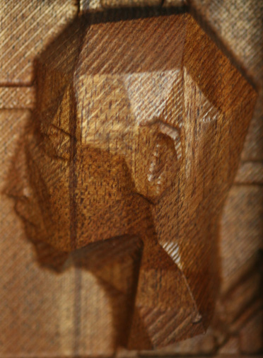

Zbrush is a fantastic tool for this kind of endeavor as the orthographic way to work is catering directly towards a 3 Axis machine. One can take a depth grab of the artwork on screen and have it milled straight away.
Cheers
Rainer
PS:Both models… as you might have guessed… made with Zbrush!
