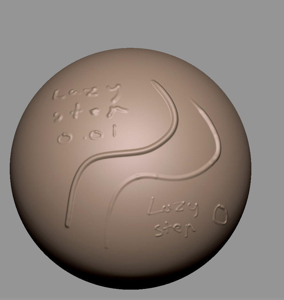

You have to use lazy mouse with lazy step turned on very low to get nice brush stroke in zbrush.
[Untitleda-1.jpg]
Its quite stupid. Since lazey step is usually used to do step type strokes.
Took me while figure it out, Funny how standard brush is broken in zbrush.
