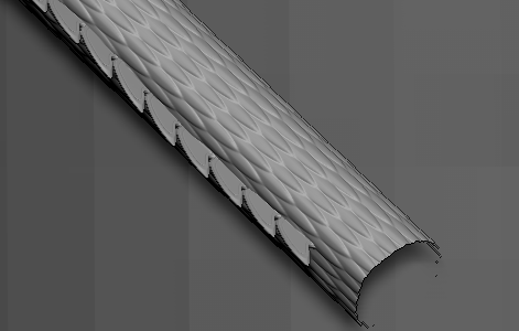

I am trying to learn more about creating dragons in ZBrush. I made a small start. See the picture below.
I am facing two problems at the moment and I hope you guys can help me out.
I made a small portion of the dragon by making a cylinder, then adding a texture, masking it by intensity and then using the inflate modifier. I then made it into an insert mesh and draw it around the cylinder.
This works pretty good as you can see to make a quick starting point for my dragon (with scales on it) up and till I add a curve modifier (size) to it.

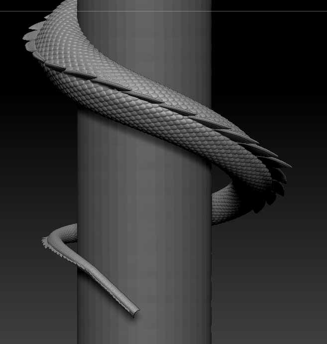

When we take a close look at the point where the tail becomes smaller, the textures is starting to stretch out a lot. See the picture below.
Is there any way to prevent this from happening?

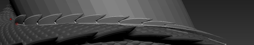

My second question is about the “back scales” that I added. I used the same technique and made an insert brush. It works fine, but not with the size modifier. When I add the size modifier this is what happens:
Instead of getting “smaller” they get stretches to the “back/ end” of the direction I am dragging the line to. This adds a weird and ugly distortion to the mesh.
Can I fix this? or what would be the proper way to do this?
