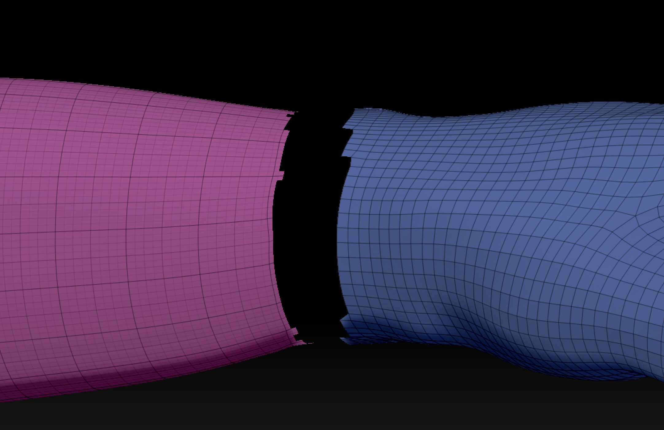

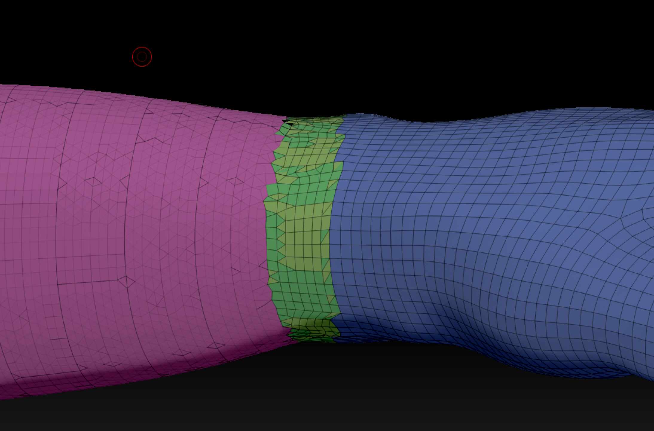

I use Zmodeler to bridge the arm on the left with the hand on the right, but it results in a disrupted mesh, which appears on the pink part. How can I bridge these two subtools without interrupt the mesh?

It looks like the points on the denser mesh on the left are welding as part of the operation. This is typically caused by one or both of the following:
The ZModeler Welding Tolerance in Preferences> Geometry is set too high for the given situation.
The mesh is atypically small in the Worldspace. Meshes that are especially small with points that are too close together may experience point welding no matter how low the welding tolerance is set. Please note that ZModeler is a low poly modeling tool, and works best with lower poly meshes.
Good luck!
         Hello @Spyndel
Thank you for answering my question and most importantly the problem has solved!
