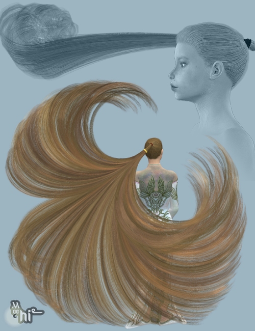

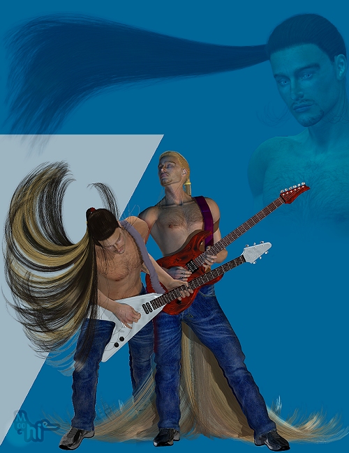

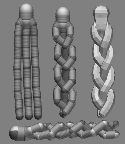

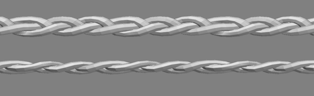

I’ve made this pose-able hair model (for Poser) using Carrara 1.1. People have been asking for braided hair to go with it. Had no idea how I was going to do it, but started playing with ZSpheres yesterday. Wahoo! It worked, like a charm. Did one set of braids, so the strands finished in the same x,y co-ordinates as they started, then copied and joined sections together in Carrara. Now all I’ve got to do is rig and texture it. Yay! The pic below only shows a small part of the braid, cos it’s very long. I’ll attach a couple of pics of the hair too, so you can see how long it’ll be. The lower two pics are done in Poser using standard models … not mine. The hair’s all mine though. Thank you ZBrush!!
divertido!!muy buena presentacion…los objetos son Poser6…?
Poser 4 (it works in 5 and 6 also).

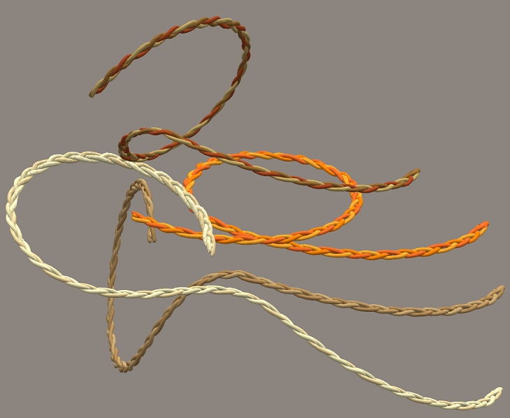

Not textured yet, but rigged and posed using IK. Wheeee!

Thanks for the links Revanto. The only braids I’ve seen before were painted onto flat geometry or a cylinder was modelled into an approximation of braids. That was how I assumed I’d have to do it, until I started messing around with ZSpheres. I’m sure this must have been done before, but it’s always cool to ‘discover’ techniques for oneself even if they’re not new. Yay!
Simple enough … three strands with enough spheres to allow one entire iteration of the braid pattern. Then keep turning the model and moving the spheres as if you were actually plaiting someone’s hair … you know … over and under and all that. Once you’ve got the first set done, take the mesh into your other 3D prog and copy and loft until it’s the length you require.

This can be accomplished in similar fashion by taking the zsphere object and turning it in the TOOL>PRIEVIEW window until the top is facing you. Then just use TOOL>DEFORMATIONS>TWIST to twist the fibres.
