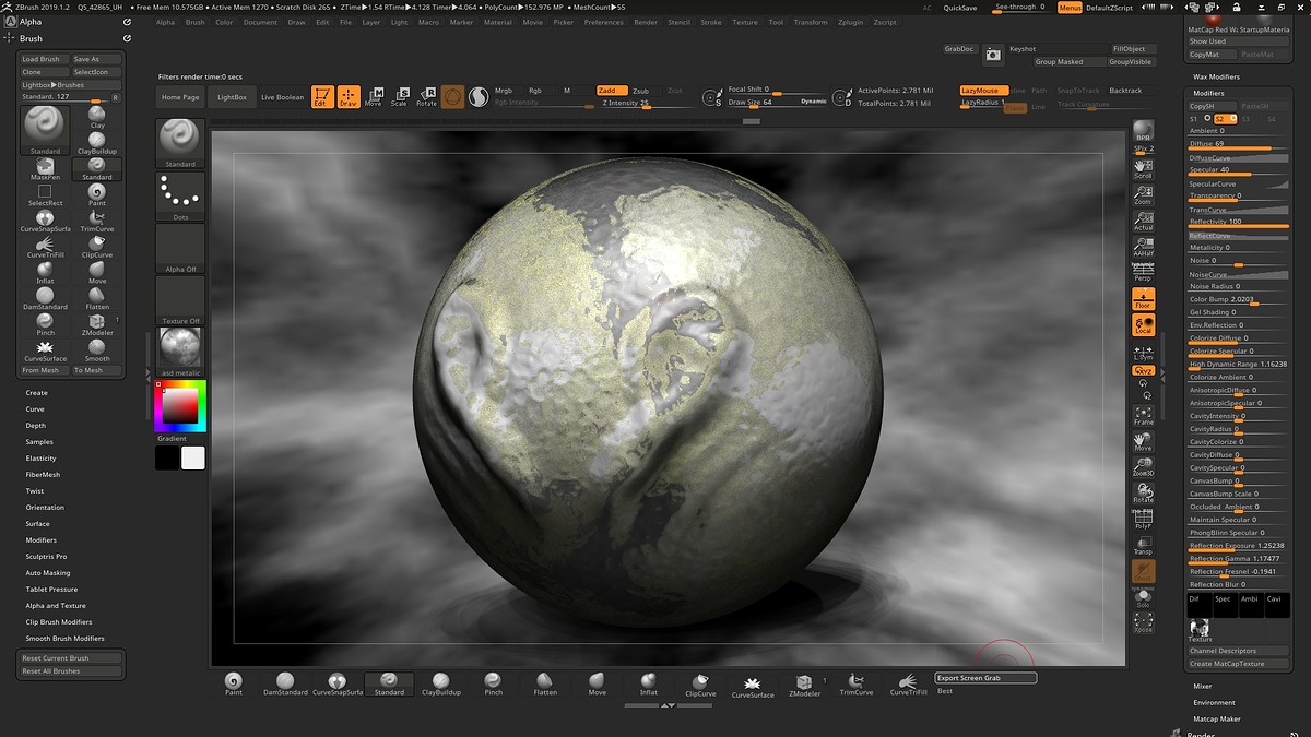

I am currently experimenting with materials but have come across an issue with reflectivity. Environment reflection slider works and renders correctly in BPR but if I use Reflectivity, no matter how much I tweak the sliders I end up with yellowing in the render it looks dreadful. I’m using monochrome colours no yellows.
As far as I can tell I’ve got the right textures in the correct boxes for reflections, which look fine until I hit bpr? I’m at a loss as to what’s going on, just wondered if anyone knew what I was doing wrong.

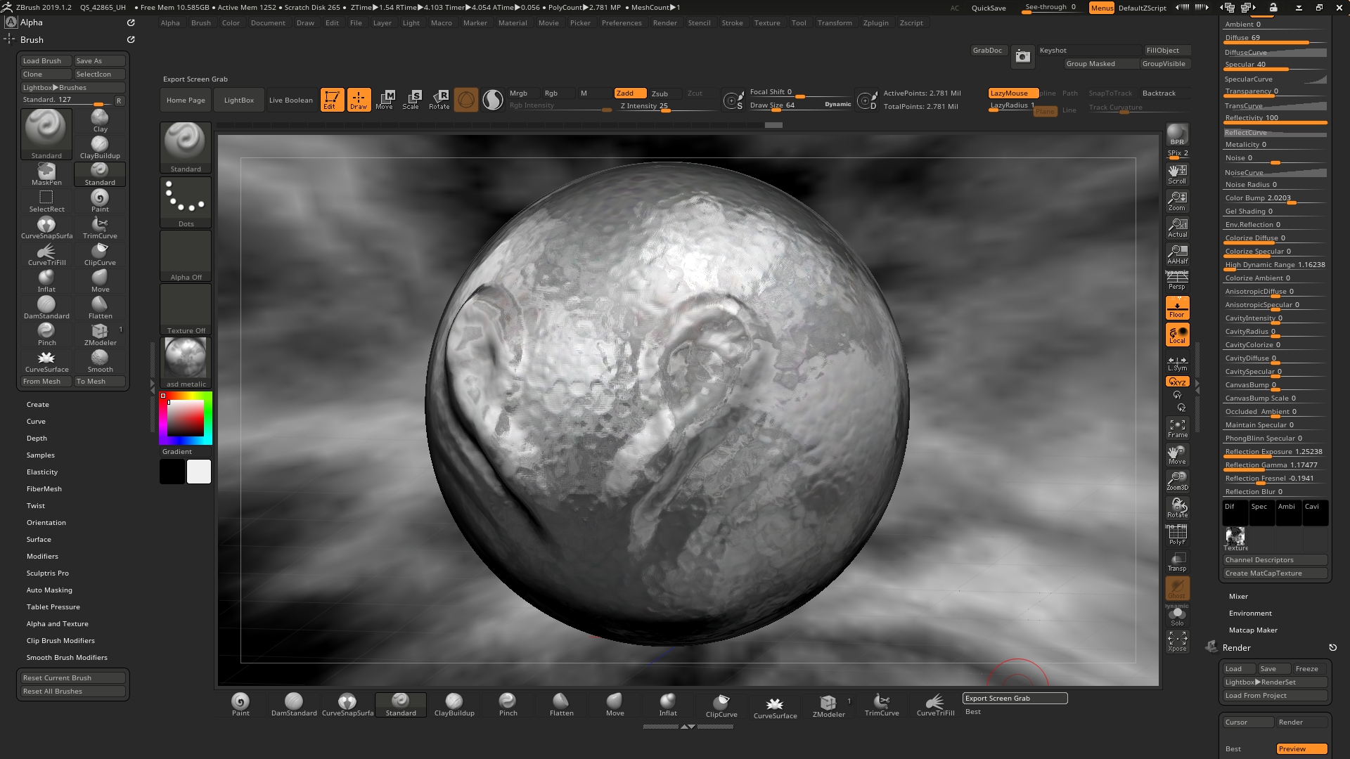

before render
After BPR

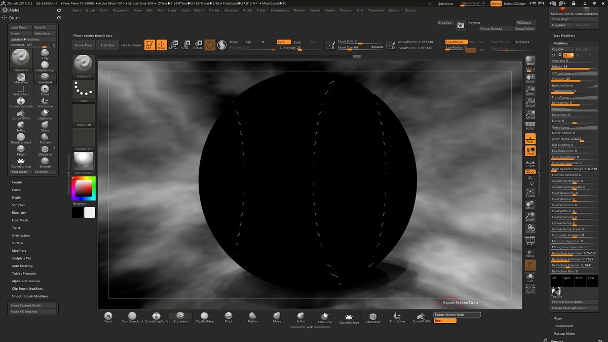

If I carry out a Best render then immediately follow with bpr I get a black sphere…

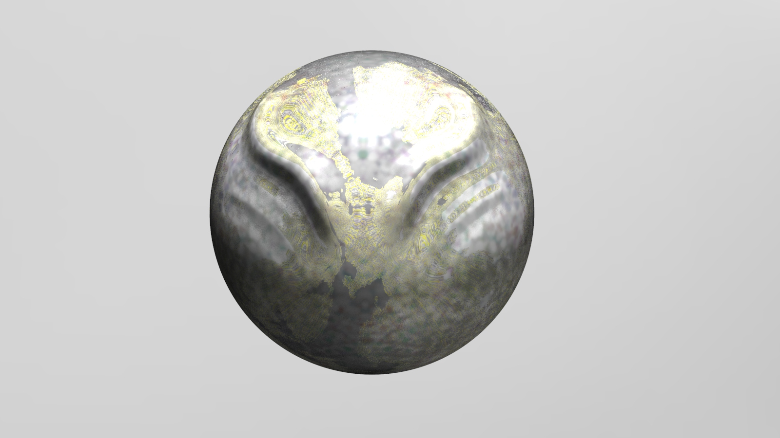

it also renders in keyshot 7 weirdly
