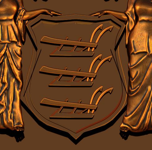

  material is the cmt deep bronze

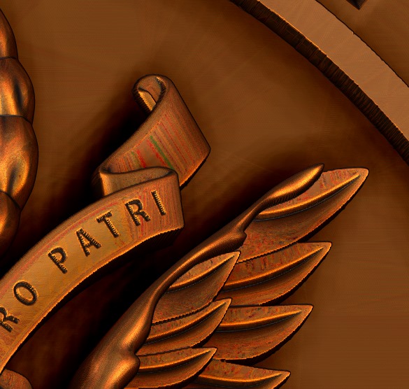

I get strange effects with that specific material too. The other reflective mats included with Zbrush dont have any issue, so it’s probably just a case of an older material not working right with some of the more recent changes in Zbrush. A lot of materials in that repository probably haven’t been updated in a while.
Its one Ive been using for quite a few months. This only started after the update. Files that just worked fine before are now not rendering correctly. An update addressing it is needed.

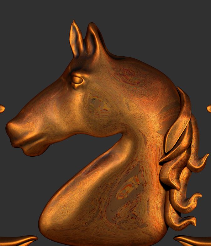

No the update didnt fix the issue. Both the color issue and ghosting of both the dynamic and regular shapes are still present.
In the S2 shader slot of the material, move the ‘OverwriteColor’ slider to 1. That should get rid of the color issue without much change to the material.
