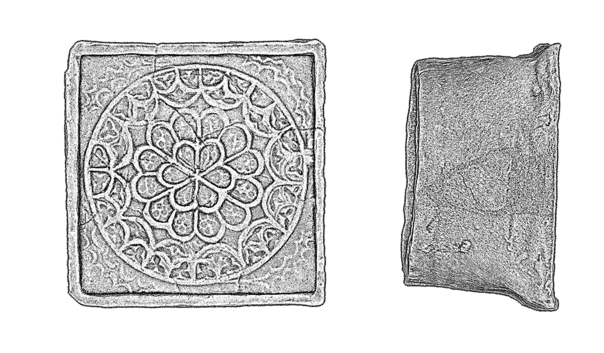

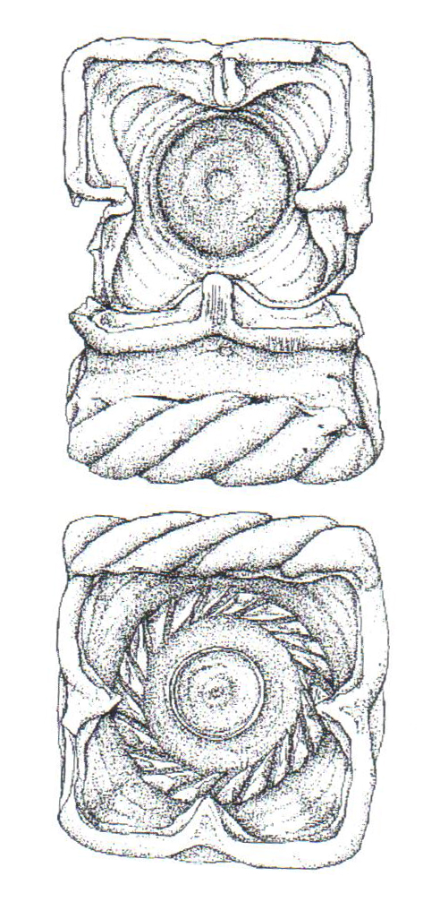

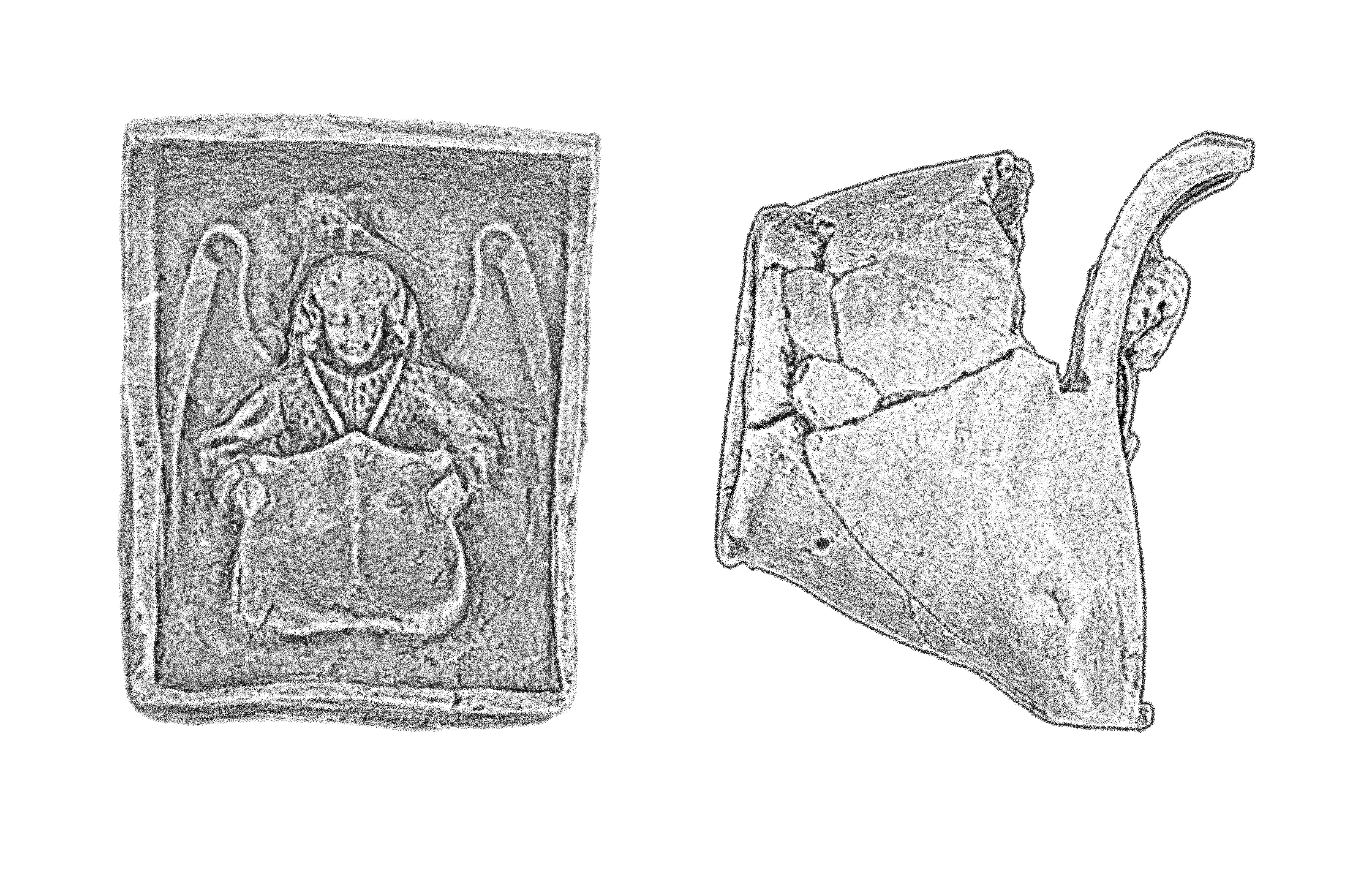

I have a problem with BPR filters.
I would like to get this effect
At the moment I managed to do something like this.
Does anyone know how to achieve the effect as in the first picture?
Hi @Ostwid!
Make sure your object is bumpy enough to generate that kind of stippled looking detail. Use noisemaker to rough up the surface and add a lot of small cavities. For your purpose here I think you would want larger bumps, not too fine.
As far as the BPR filters, I find it’s best to start with something in the ballpark of what you’re looking for, and to tweak from there. From the BPR Filters menu, load “Zhelong_Ink” from the Lightbox Presets. This used in conjunction with some of the default Framer or Sketch materials in Zbrush should produce results close to what you’re looking for. Adjust further to tastes.
