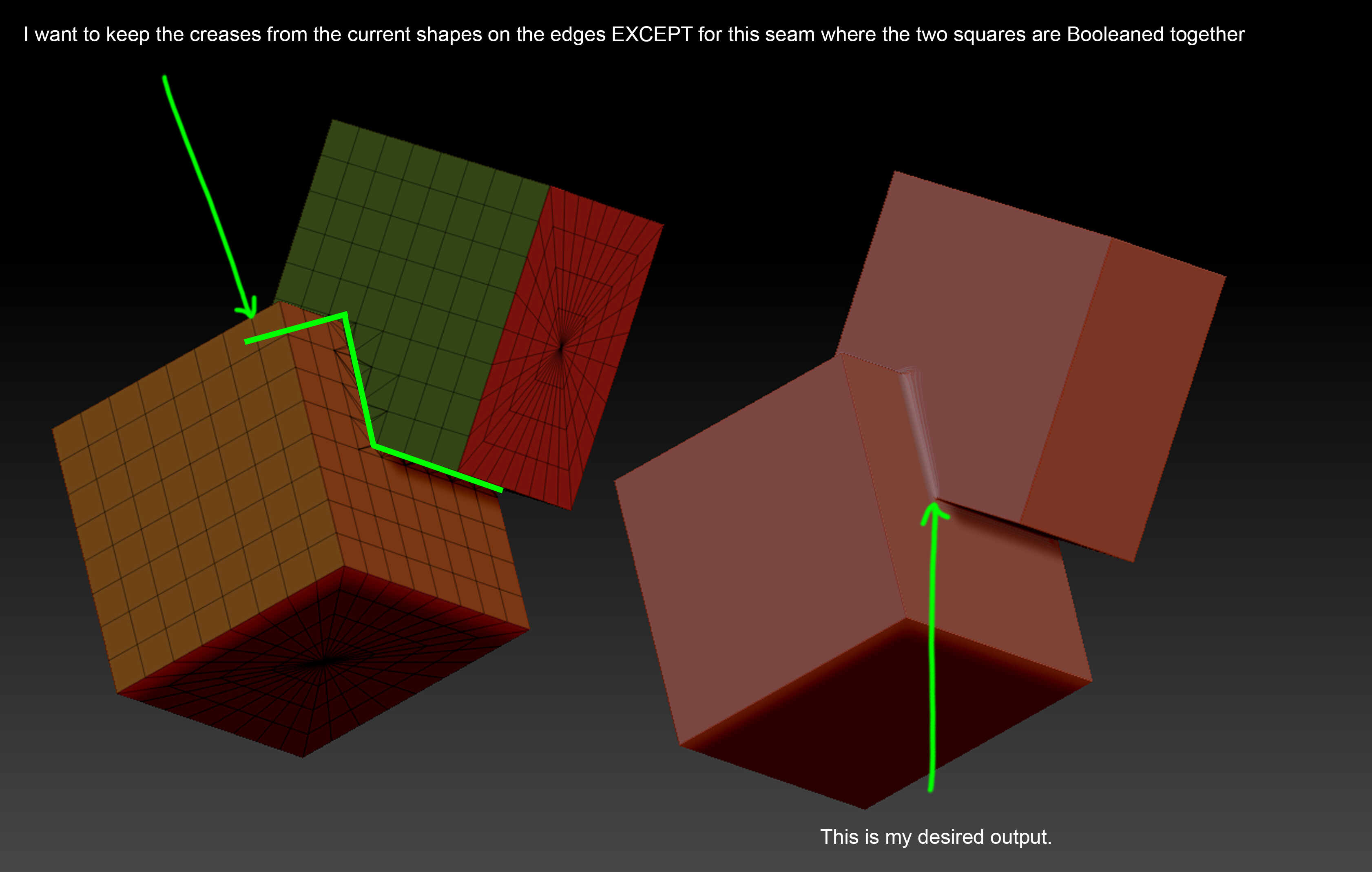

So I have noticed that Boolean removes creasing during the operation. Is there a way to preserve them?
Normally this would be easy as Boolean preserves polygroups so I can use Crease PG and just manually remove those transition creases but my client wants a workflow that removes handwork if possible.
Any ideas?

Thank you for that reply. Your answer is actually pretty close to the solution I presented on the right with a Crease PG followed with proper ZRemeshing. Then I subdivided a few times after removing the desired crease between the parts. I am very familiar with all the methods you presented and can second the utility of all your tips which I appreciate you putting so much care into:)
My goal is to create a scenario where I do not have to apply any hand-work. Currently the only part I did by hand was remove that specific crease between the two shapes(the two boolean cubes).
That is why I was asking if there is any way to preserve creases from parts going into a Boolean Operation as this would automatically give me a mesh close to what I want. I could then ZRemesh with Keep Creases on.
Unfortunately I know there isn’t a lot of options to further control a boolean beyond addition/subtraction/union. Perhaps there is another method I’m not thinking of?
