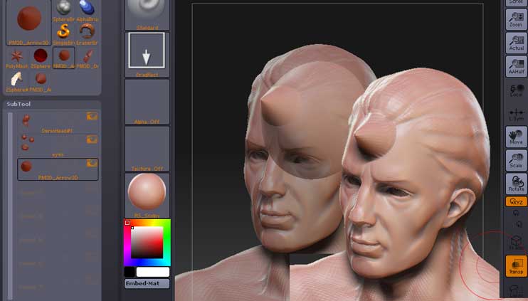

The ZProject brush would be a good way of doing this.
Append the horn as a subtool and position. Switch to your main mesh and use the ZProject brush to project the horn onto the mesh. In my example I used the arrow tool.

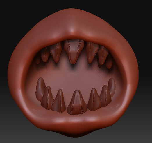

Hi friend:
i made another zscript where i imagine what you want to resolve, a mouth or cavity with tens tentacles or teeth,etc…
look this way…

You’re too kind with me :smiley:
Making those zscript for me, that’s really cool.

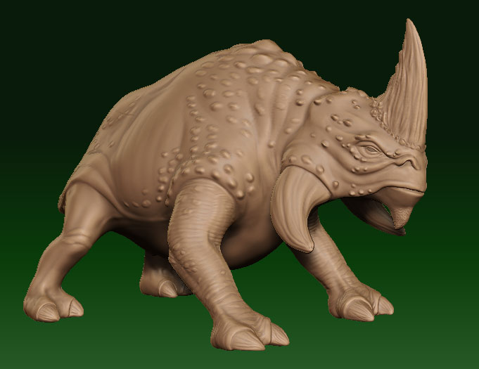

I think that If I show you the model I am doing it will help.
There are a lot of these little horn covering all his body.

Well your model is just outstanding!! Looking about your need why dont you intent with the snakehook brush? give a try…

I remembered having read somewhere about the workflow of ILM on the Kracken. They have done differents suction cup who were very detailed, and then they use them to stamp it on the tentacle, they ended up with the result we are knowing.
So I thought I could use the same technique, and making many littles horns who will be very detailed, and then stamp them on my model, like that I could cut my working time down and get a great amount of details.
Thanks for the congratulations :D.

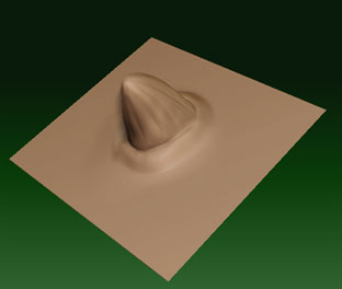

I think you should have another look at doing this by the ‘grabdoc’ method
in the alpha palette…as it seems horns are a shape made for this technique:
That alpha was created from a horn made of a plane3D at around 1.5 million
polys, then I used the layer brush with an additional value of 20 on the ‘brush
modifier’ and a 100 on intensity. The sphere itself is level 5 sub-d (around
3 million polys) to allow for nice detail. I used the dragdot stroke to lay
them down. And of course, it’s still rough and could use cleanup, as this was
only to use as an example.
Thing is, once you put down a ‘straight’ horn you could bend them with
move tool, etc. for more style.
cheers.
