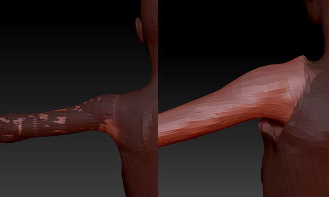

I have been importing from Smithmicro Poser a Genesis figure for further improvement. In order to enable me to sulpt at difficult body regions like the armpit or the inside of the limbs, I need to have raised arms/legs and for this purpose I imported a standard pose. The final figure shall have the arms lowered again.
Several video instructions at e.g. YouTube leave the impression that normal transpose is really simple. Everything works out smoothly there. What am I doing wrong when I
- try to establish an automatic mask of the arm (Rotate button > dragging the action line with the LMB). The mask is not covering the whole body of the arm as shown in the image on the left.
2. am masking manually (SHIFT > standard brush > inverting mask) which works perfectly. After rotating with by using the action line the arm is kind of rotating but at the joints all polys have been totally distorted like shown on the right.
I did not subdivide the figure (resolution: 101666 Polys)
