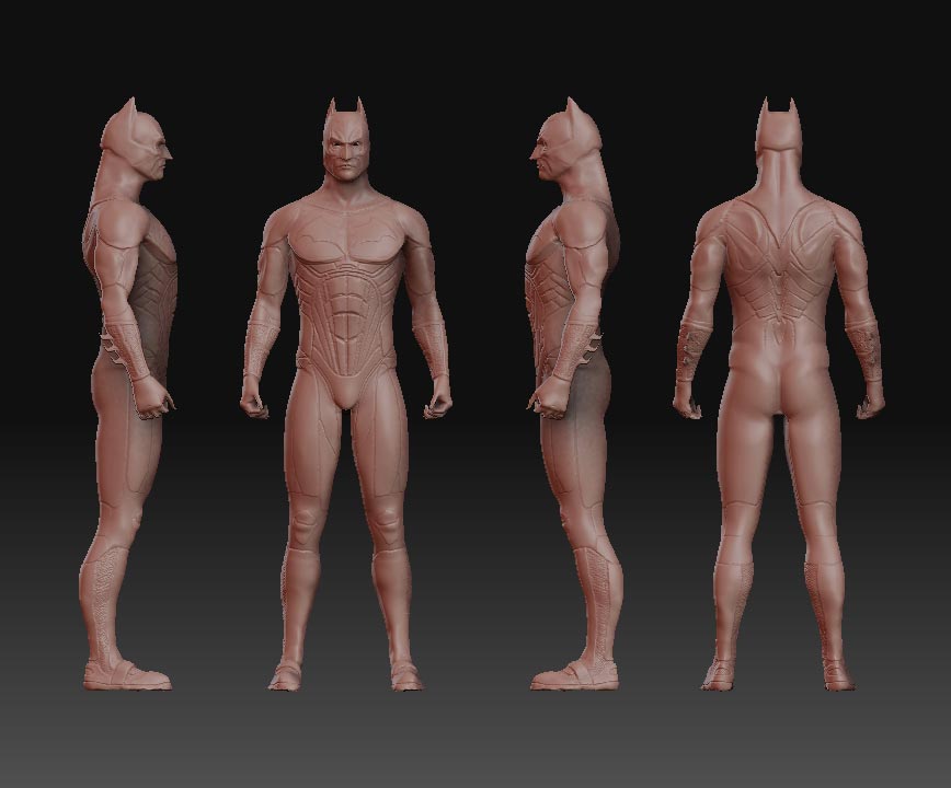

My first try with zbrush
If someone can tell me how can i put texture on subtools, i will really appreciate it.

looks good! concerning the textures i dont think you can use more than one texture per tool (therefore it will be the same texture for all the subtool) unless i’m missing something…here is the way i proceed to get lots of textures on the same model:
considering each texture are 2048* and i have let say 4 of them, and my model is in four part (one texture by subtool then) i make a 4096texture with all the four textures, ansd move my model’s uvs to match a layout that would fit that new texture (in maya, it is very easy to create a quick mel to move your uv page from one unit to the right/left/top or bottom, and scale or de-scale the all group to fit the Uv page…export all those .objwith this new layout, load ure nice 4098 in zbrsh et voila
i think zbrush3 can handle a 8192 …need to check though
hope that helps
Aside from Abe’s advice, it seems that the only way to texture your model is to apply the texture, then convert it to polypaint colors. This is helpful in ZBrush, but not so much for exporting to other apps.

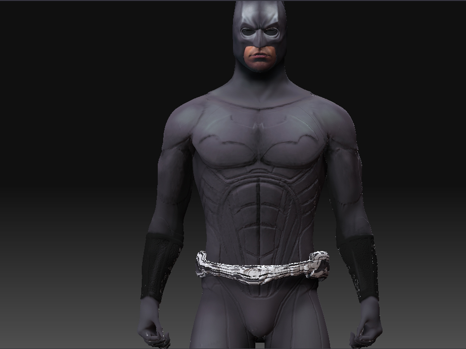

Here’s the problem, when i append my subtool it takes the texture from the main tool…How can i remove the texture only from the subtool?
Here’s how ugly it looks when i append the belt :lol:
[attach=62529]bugnatovu0.jpg[/attach]
Borden, with body subtool selected (hide the others) go to a texture submenu in tools and check Tex>Col.
Now you can disable this texture and aply any other texture for all others subtools.

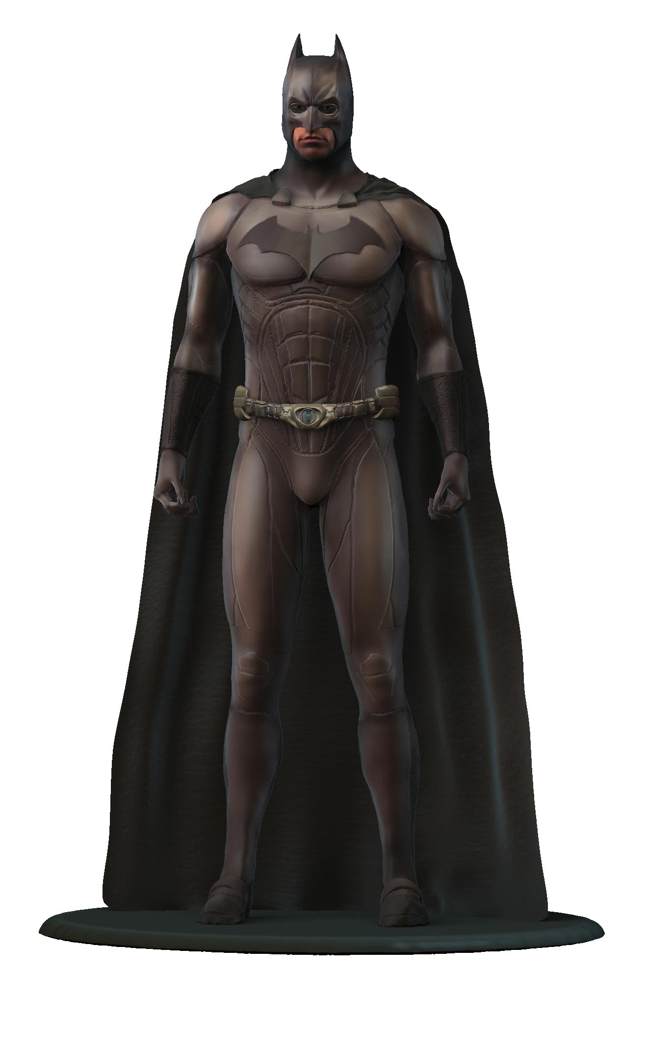

Thanks for all the help guys, here’s an update(this is not the final render):
[attach=63609]tretirenderas9.jpg[/attach]
Looking good.
So how did you resolve the texture problem with subtools? I am getting ready to mat and poly paint a guy with about 10 subtools so i could use your advice as to how you eventually resolved it…

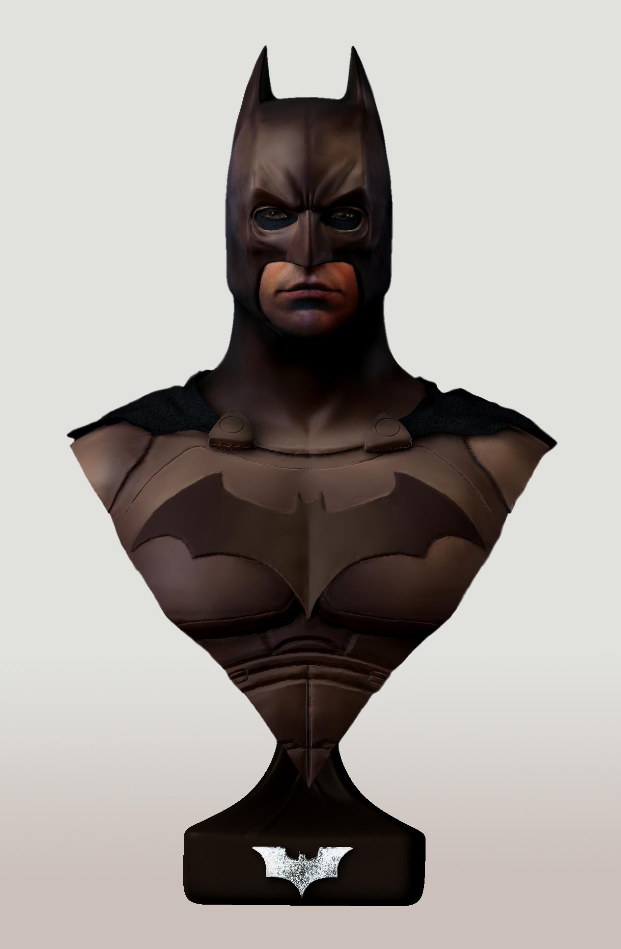

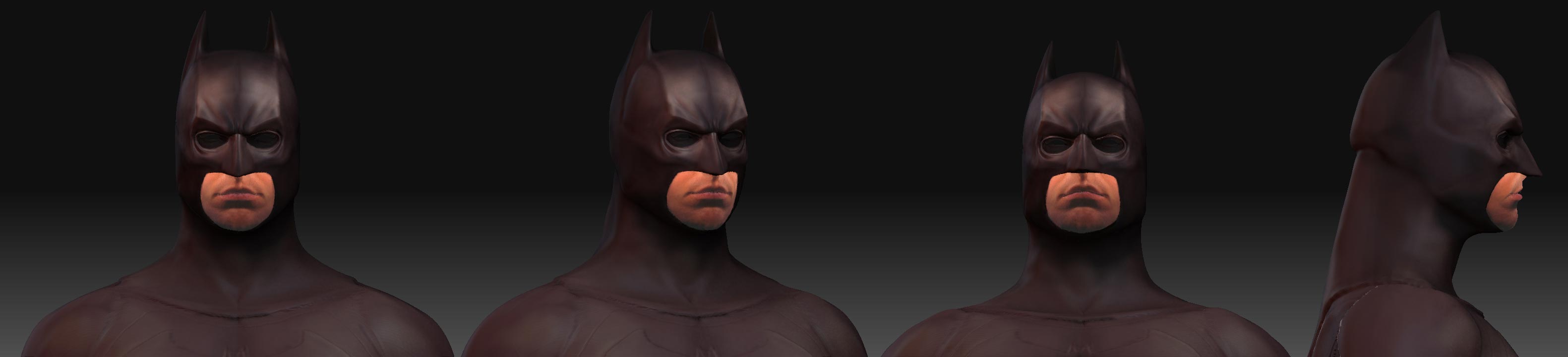

Hey guys, didn’t have time to post lately, but here’s the major update to my batman model, reworked everything from scratch, because i wasn’t satisfied with the past model.
Hope you guys like it!
p.s.To all who still haven’t figured out the texture problem, Melantonio’s advice is the solution i used.

Much better bat suit. And good likeness of Christian Bale!
Thanks, glad you like it!
excellent work, Its coming along GREAT… the head is super
Much better on the bat suite. What is the max polycount you are working with?
very nice work with Christian Bale face!
Thanks for the comments, my main goal was to make the head look like Christian Bale’s and McGergs the model is made of 15 subtools and is almost 10 million poligons.
