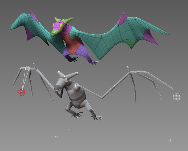

There ya go, duplicated my results with butter-like smoothness. Just by setting curvature to 80+ in this case. note the seprate joints per finger to keep things from getting messy.
Also divided the mesh so you could see the shape rentention.

Many thanks Art Machine
I will try this setup asap, I think the problem was that I had too many spheres in my setup, the membrane wasn’t stretching between the finger ends as a result.

Can you post the ZBrush of this bat setup. It would be a great base model to create many other creatures from. Bats, Dragons, Birds.
Thanks,
I’ve added the ztl to my previous post. Use it in whatever way you want. :slight_smile:
