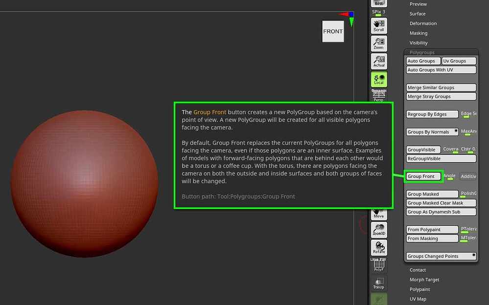

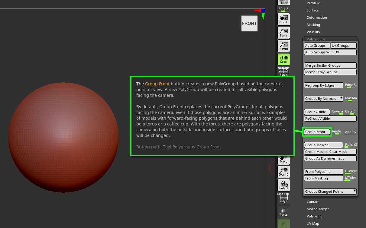

Hi @katosaori
In case you are not aware of this, it is very easy to hide the back when you use the “Group Front” button in “Tool > Polygroups”. You can use that to create front and back polygroups then just “Ctrl+Shift+click” on the front to hide the back.
Hello @zber2
Thank you very much.
I didn’t know “group front”.
I will try it.
