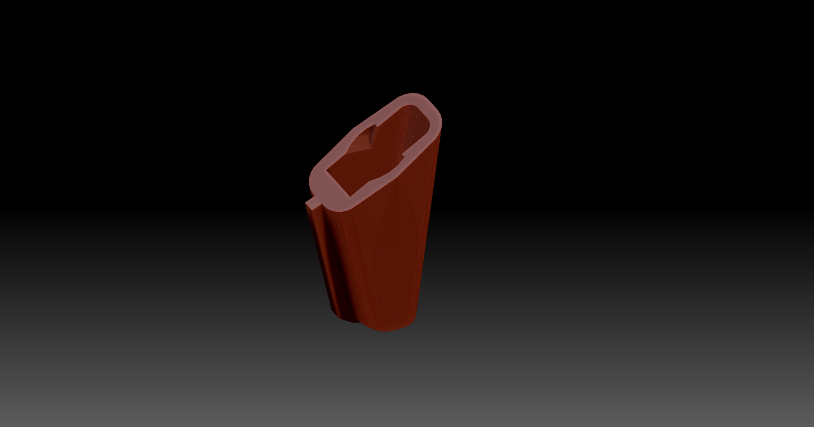

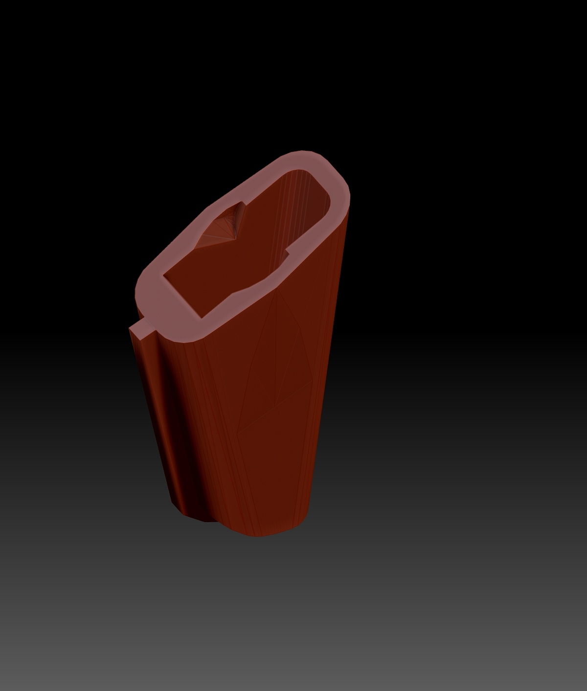

I’m currently modelling parts for an action figure where I don’t want do modify inside parts of the model. When I use backface masking both with brushes and for the mask itself it usually works. However sometime the masking pen and smooth brush bleeds into to the inside geometry. This is incredible frustrating as it’s hard to know if the backface masking is protecting the inside or just 95% of it. How can I be 100% sure not to modify the inside of this model. I don’t trust backface masking anymore as it seems to rely on the brush size and models size as well. I can’t use a technique that works sometimes and sometimes not.

Polygroup the interior polygons (poly group by normals will probably work here–if not you’ll have to hide the unwanted polygons manually for the purpose of grouping), and then either mask or hide that polygroup while working.
It may be that parts of your model become “forward facing” as you rotate. Backface masking is an automatic and dynamic effect based on the normals of the mesh, so the shape of your model and its rotation relative to how you are working affect the masking.
Yes, it might be several reasons for it not working 100 %. I made the inner part its own polygroup. Then I hid the rest and masked it with the mask rectangle and now it seems to be completely masked. It just a bit of a hassle to do on more complex parts.

As far as taking part of the hassle away goes (eventually it’s not a hassle at all and you’ll have mastery over all the ways to do this quickly and accurately given enough focused practice) I can recommend some easy outs that work 100% of the time at least 50% of the time in zbrush to get you there without much hassle and that’s under Polygroups menu and group by normals and group front. Most of the time to establish a quick blocked out polygroup to do something like protect backfaces you can group front in one button click. Turn your model around and ctrl+shift+click the back facing polygroup and hide it then group visible the front facing part and then you can hide your back facing part so easily, really no thinking required.
