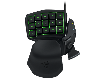

I have always used Razer tartarus for the shortcuts in every program I’ve used and that’s what I did with zbrush as well. (I mostly use it for the brushes)
razer-tartarus-chroma-01-02__store_gallery
