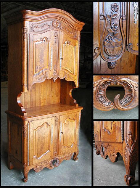

I am a clasically trained woodcarver and am now getting into CAD designing and transitioning to CNC router based woodworking. I plan to buy a cintiq digital on-screen drawing tablet. I would love to be able to use Zbrush or something to simulate carving gouges and carve onscreen… is this a non-existent reality at the moment?
Attached is the kind of ornament I want to produce digitally. We hand-carved this china cabinet in California.Karas jpg 190.jpg
