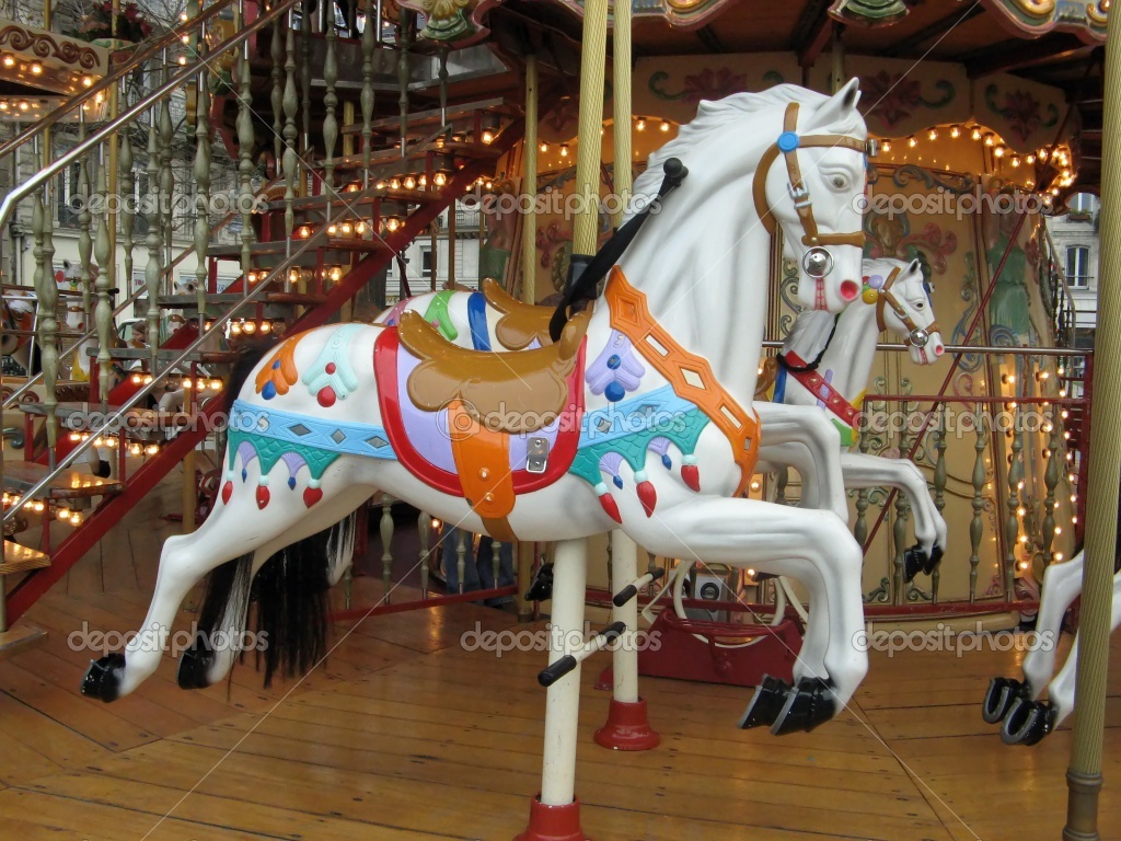

I’ve tried everything to get things looking good, but I’ve only been half successful in every attempt. I tried modelling the pieces and then attempting to use the bend and ffd modifiers in Max. It produced adequate results, but doesn’t snap to the surface like it should. Then I tried retopologizing to make the accessories and while they matched to the body like I’m wanting you can only do so much to add to the retopologized mesh once the shape is laid out. For example I extruded the faces but couldn’t really do anything else to get the round look of some of those elements. Plus it’s not accurate in terms of edge placement among other things. Then for some reason I thought maybe the Matchmaker brush would help, but that definitely didn’t work. So that leads me to my question. What do I do now? Here’s the reference of what I’m doing. If I need to post wips of what I’ve attempted I can.

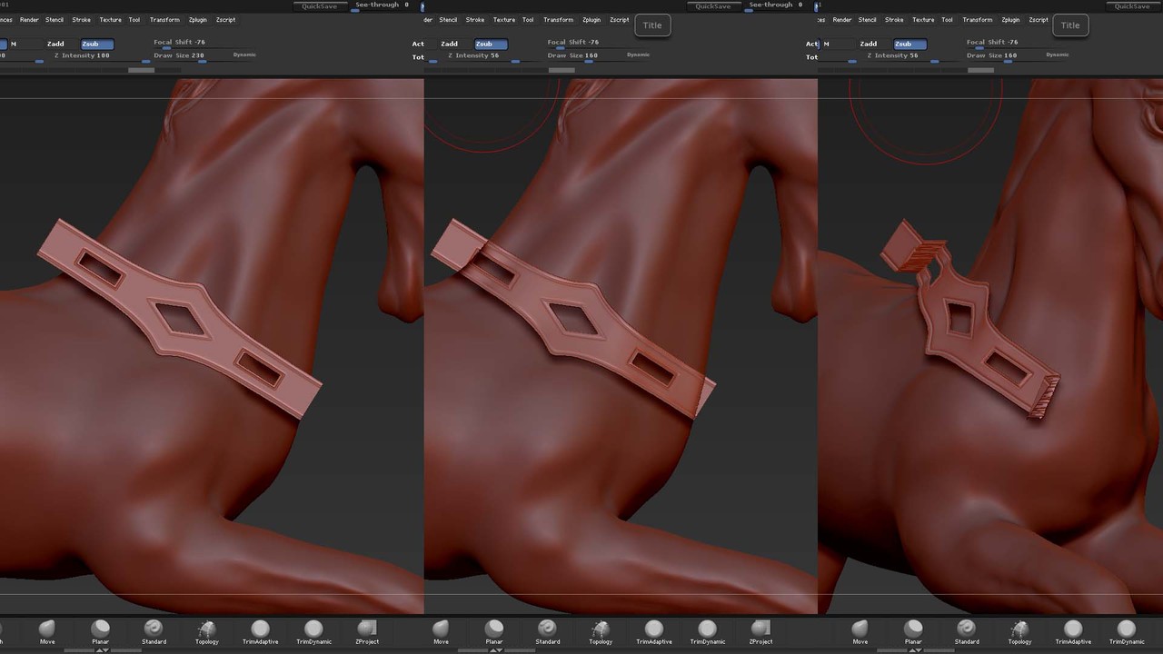

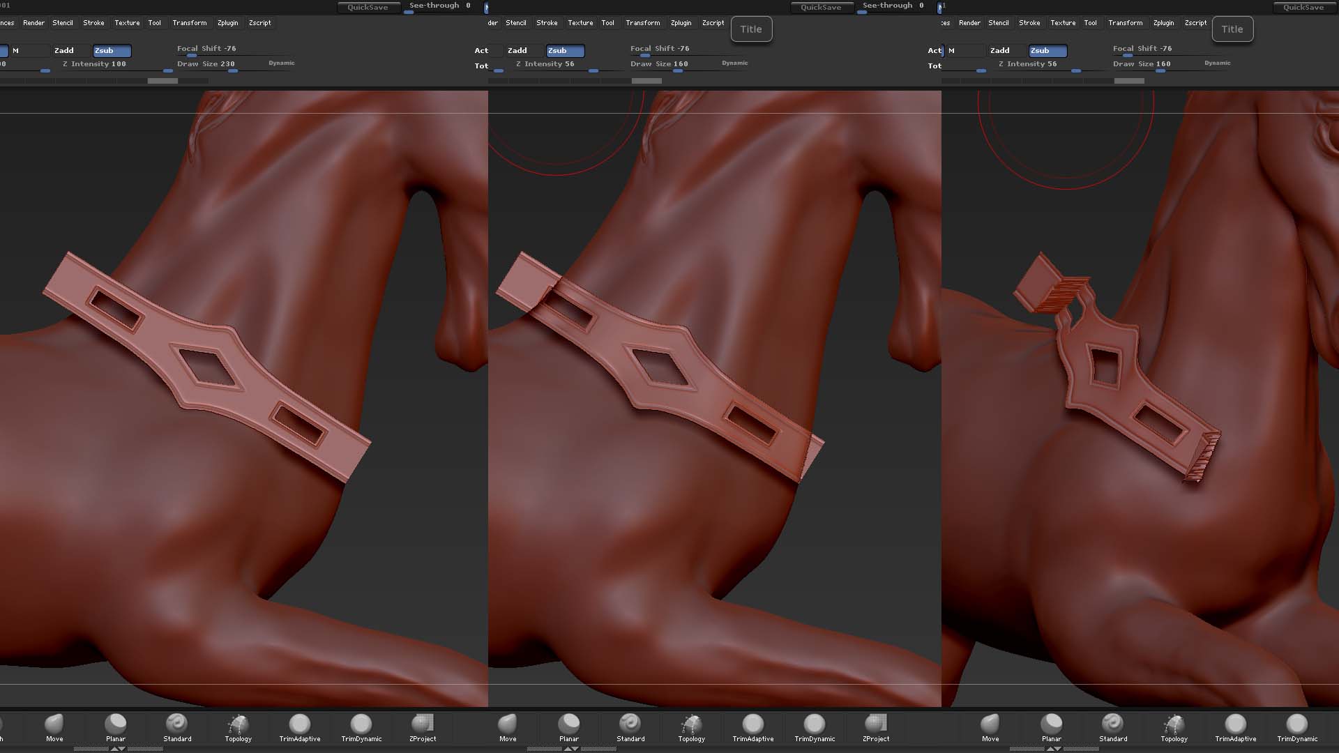

So I gave this a shot and it worked so so. As you can tell there’s a few issues.
One being the most prominent in that this brush only works in the view that you drag it out from. Since I need the harness to wrap fully around the body I’m wondering if maybe importing already bent by help? Then when I moved the harness closer towards the horse it didn’t entirely conform together. There must be something to fix these issues so any help I’d appreciate!

Mask areas that are close to where they should be, use move or move points or maybe even transpose to get it closer.
You mean masking the harness not the horse right? I just masked the ends off the harness, used the matchmaker brush for the unmasked parts. Then rotated the camera, inverted the mask and tried using the brush but the ends didn’t project to the surface like they should. Instead they projected maybe like half an inch. The harness is just a plane so not sure if that matters. You think bending it before importing and using the brush would work?
Yes, I meant the harness. If you can model it elsewhere and import it, whatever works for you.

I tried that too but the mask wasn’t completely even which meant the extraction wasn’t smooth. There’s gotta be a way to use the matchmaker brush to get these ends bent. Thats the only realy issue. I ca. Fiddle woth the middle of it but the ends are the real issue. The same thing will haplen with the other accessories that wrap around the body and for any other model for that matter.
