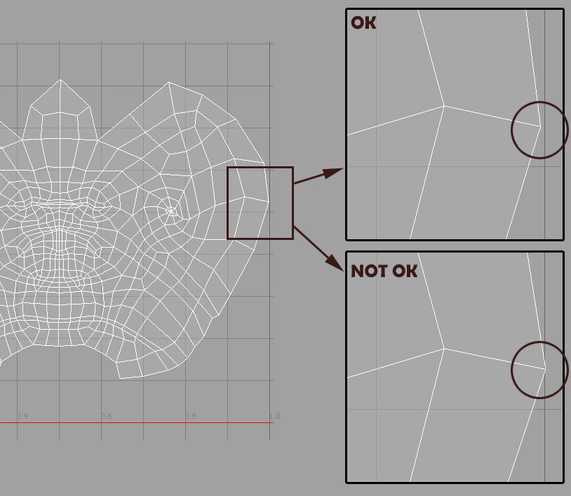

I didn’t try with mod 302 yet, but it works perfectly with 301. But you have to know one important tip : your UVs must be strictly between 0 and 1 value, it means that you have to check that no UV vertices are strictly on the box edge in modo.
