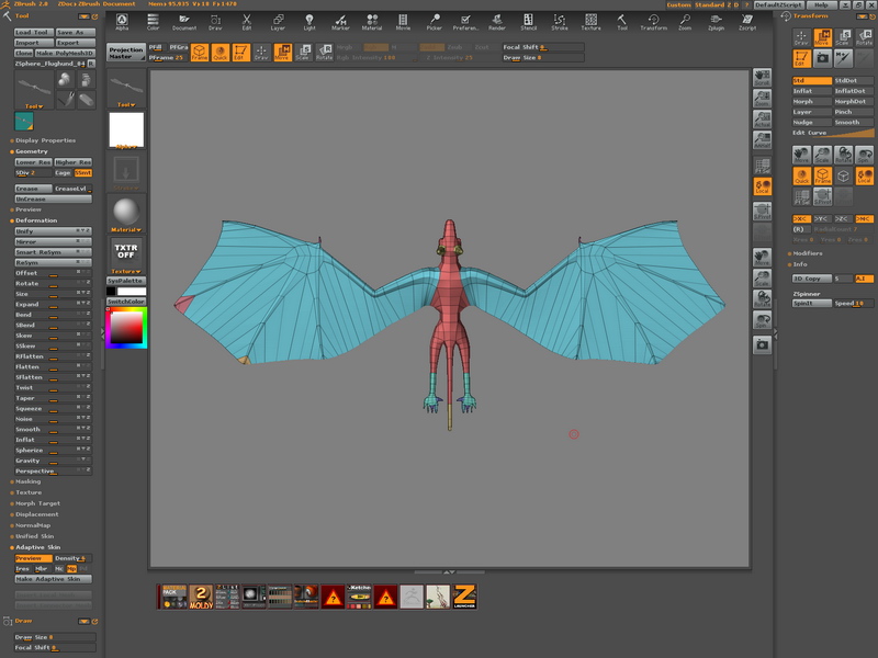

This is the original Mesh as it comes from the ZSpheres into adaptive skin preview
[attach=13635]01_Mesh_orig.jpg[/attach]

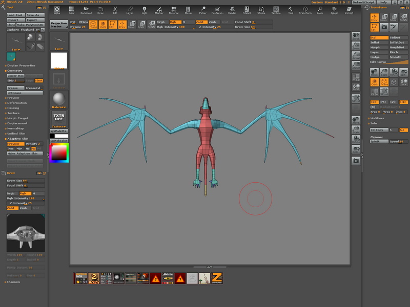

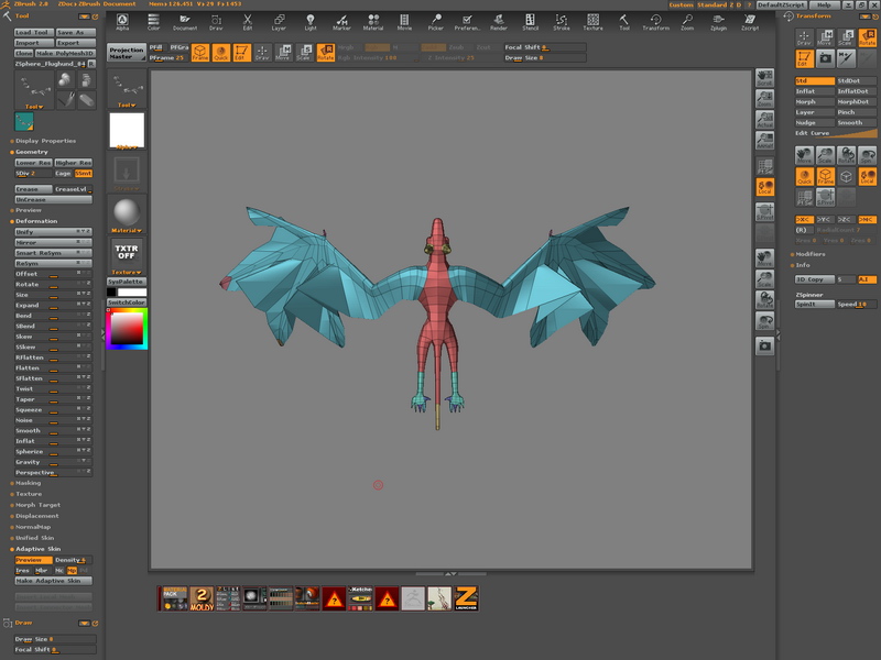

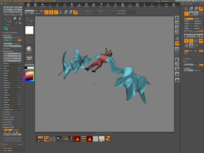

This one shows the mesh after Vertex moving (Adaptive Skin res=6, Geometry SDiv=2) [attach=13636]02_Mesh_ASkin6_deform_geomSDiv2.jpg[/attach] This is after storing Morph Target and pressing 'A',Geometry SDiv=2 and 'Cage'-button [attach=13640]05_Mesh_ASkin6_deform_geomSDiv2_cage.jpg[/attach] This one is the mesh (after doing cage in SDiv=2) and put slider to Geometry SDiv=6 :( [attach=13645]051_Mesh_ASkin6_deform_geomSDiv6.jpg[/attach] This is the Model after Posing :confused: [attach=13641]06_Mesh_ASkin6_deform_geomSDiv2_posed.jpg[/attach] And in Higher res (ASkin=6 SDiv=6) :cry: [attach=13642]07_Mesh_ASkin6_deform_geomSDiv2_posed.jpg[/attach] So there are 2 Problems at once: 1.)How can I get the Mesh to be bound to the ZSpheres for posing and 2.) not to be distorted in higher resolution?

First off, don’t use the Cage button unless you’re ready to create a displacement map and export both it and the base mesh. The cage calculates a mesh that as closely as possible resembles the high resolution mesh. It is meant for exporting to another program; not for use in ZBrush itself.
What you want to do is the following:
  1. Create your ZSphere model in the default pose.
  2. With the ZSpheres visible, press Tool>Morph Target>StoreMT
  3. Turn on the preview and assign any UV mapping that you want. Also do your sculpting.
  4. Return to the ZSphere view and repose the model.
  5. Activate the preview to see the new pose.
The morph target is stored before you ever start sculpting or texturing (at any subdivision level, including level 1) and the cage button is never used.

I tried the procedure as you have explaned above, but it just doesn’t work for my model. I always get that bad distortion in the wings when posing the model as shown in the last 2 pictures of my last post (aside from the Problem of strong smoothing/loss of shape in the membranes in higher SubD-levels).
I guess this posing feature doesn’t work if some vertices are moved too far from the ZSphere. :frowning:
