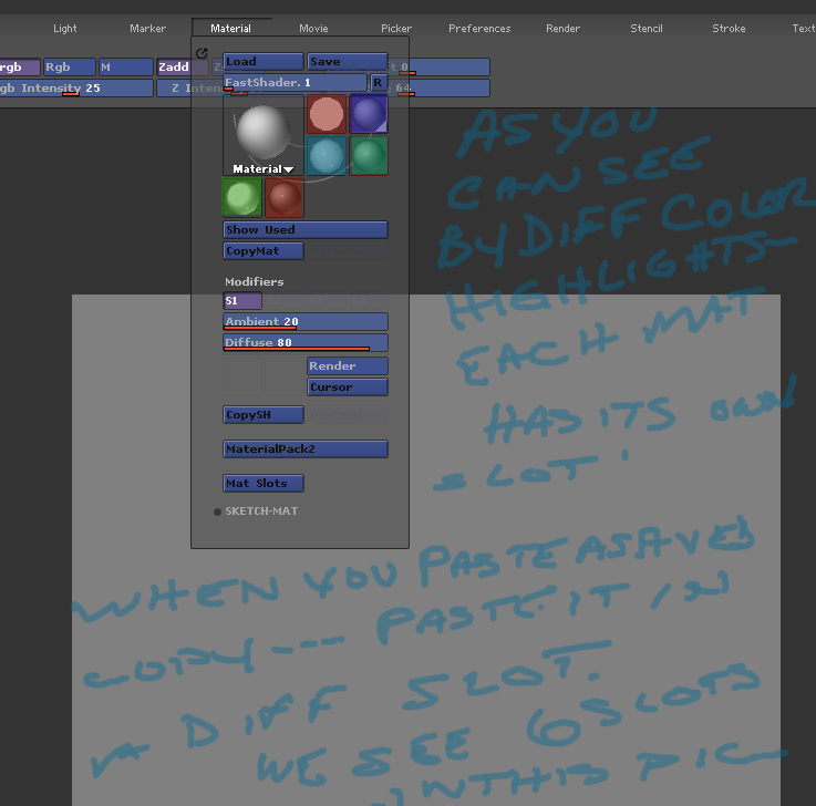

maybe this will help you visualize what we were trying to help you with a little…if not…say so and I’ll try to help you clear this up better.
[spaceghost1001.jpg]
what that means is if you have 10 objects you want to share the same or basically the same material buttttttt be able to change one objects material at will…then you need to save 10 instances (renamed mat001-mat010) of the same material then when you draw object 001 load mat001 before moving to obj 002 in which you would load mat002 etc.
that way if you change mat001’s slot…mat 002 etc will not be affected.
