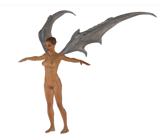

Carmen ZPost.jpg First, I am not a natural English speaker, forgive me if I sound childish, imprecise or even rude.
I’m posting “Carmen”, an angel who looks and never acts. Just puts you nervous. She has nothing inside: a black space.
This is my first finished model in Z and I have tones of questions for any patient reader.
  1. -does Zbrush accept UV Sets? - I did “Carmen” with UV Sets and I have to render each part one by one. Horrible. If it is not accepted, any solution?
  2. -could anybody explain about UV unwrap in Zbrush, or refer a link? Thanks.
  3. -how do you add props to a model? For ex., if I wanted eyeballs, clothes… for a Zbrush render (it’s fast!). - and each piece with its own texture and material.
I’ve got more questions but this three are enough to start.
Congratulations to the Community, you are… em… wich word? active, generous.

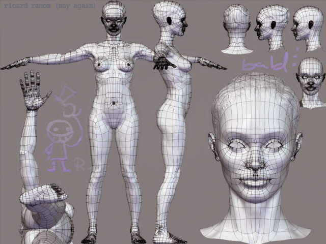

Please post some more wires if you can, the model looks so good. I love it.
…Robert is Carmen? :wink:
To Giantsum:
-very very kind. I prepared some wires: you will see the wires of the base-mesh over the top-smoothed model (5 divisions). If you notice anything wrong about the anatomy, please, give me a warning. Female anatomy is challenging, specially if I try to avoid some stereotypes. (I forgot about the wings, but they are nothing special.)

I think I like this type of wings better. Although it would be cool to see them skin colored. These kind of remind me of bat wings.
  1. ZBrush can not get UV sets. if im not mistaken, then the obj standard cant either. also make sure you only use 0,0 - 1,1 uv space.
  2. there is no unwrap tool in zbrush (no pelt map). the only special tools zb has are the GUV and AUV. both of them are nice, nothing more. and create problems down the road. I strongly recommend doing your UVs on a different soft (unfold3D is the best IMHO)
3)you can add as many objects to the canvas as you like. you just need to understand that once you switch to another tool, the poly information of the last object is translated to pixols. which mean you can not transform the object again or do anything to it as one object. however the pixols keep allot of info in them, including the Z and the material. there is a way of making many objects in to one using the marker but its to complicated to explain in here, search for it in the books.
