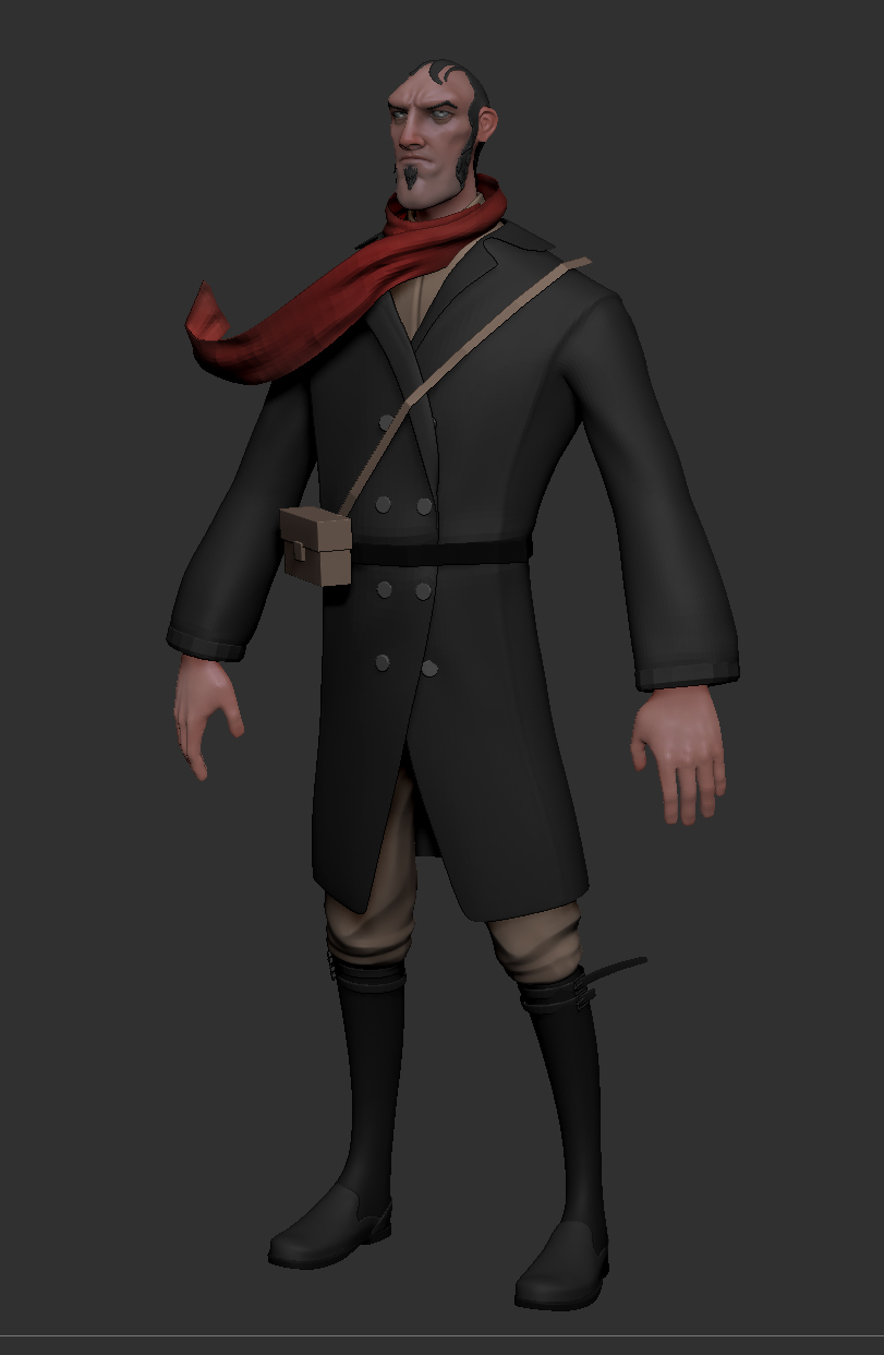

Here is what im working on. A small personal project :slight_smile:
It began as a dynamesh face and then the project grew on me.
