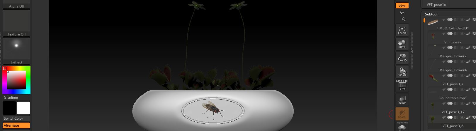

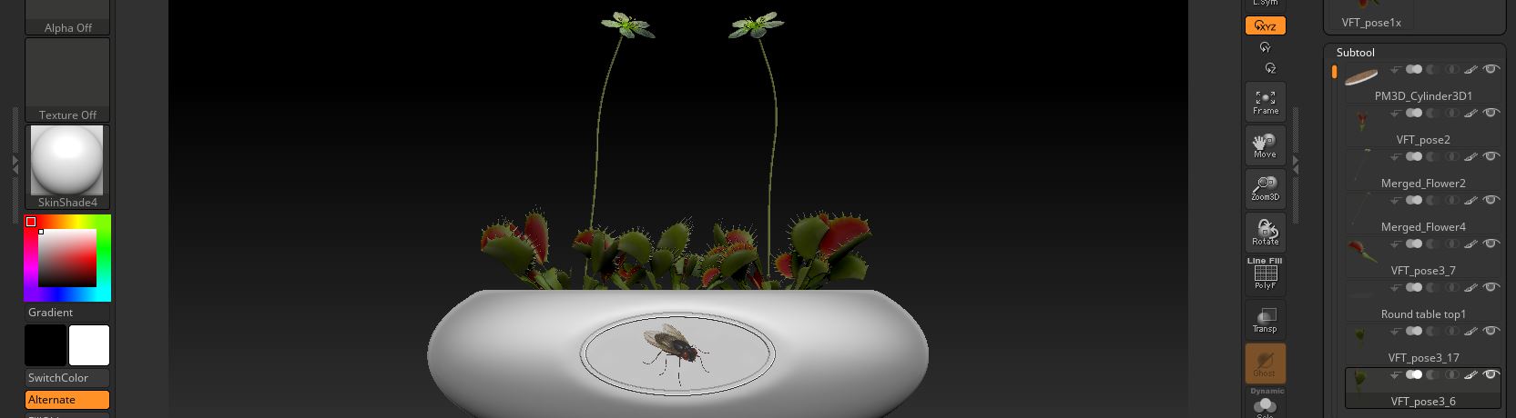

I have multiple subtools each with unique Mrgb’s. All have had FillObject perfomed on them. The scene looks great as long as I have a white material selected in edit mode. If I select another material ie a reflective material or a material with color other than white, Every subtool is affected by this material. The subtools don’t completely change to this material but are a blend of the subtool material and the now selected material. Selecting Flat Color is the best as it seems to have zero effect. However the Zbrush to Photoshop plugin complains if I use Flat Color. I am expecting the subtools filled material to stay as they were filled. Some of my subtools are painted using a texture with spotlight. Others are just a material. This is preventing me from moving forward learning my Zbrush skills and hurting my brain. I feel I must be missing something basic. Any help would be fantastic.
See below the only difference between these are the selected material.
