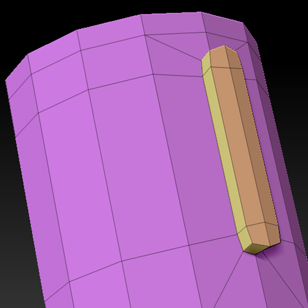

I watched your video. It’s difficult to make out what is going on, but I can’t reproduce your issue under normal circumstances. You’ll see I’ve modeled something similar to your topology:
zmodissue
If I had to guess, I’d guess you have a combination of problems going on. I was able to start reproducing similar weird behavior by scaling the tool abnormally small in the worldspace, AND by using a brush radius that was too large for the areas I was trying to target.
I would suggest performing a unify on your model to make sure it is in the “sweet spot” for working in Zbrush. Some reasons you’d want to do this are shown in this video. Meshes that are abnormally small or large in the Zbrush worldspace can perform oddly.
And then by way of general tip, reduce your Zmodeler Brush radius so you aren’t involving unwanted elements in your operation. I notice also that your polygroup target is set to “polygroup all”. Polygroup island would be a more accurate target for that situation–if you have other polygons you arent aware of assigned to the same polygroup, it can cause unexplained behavior.
