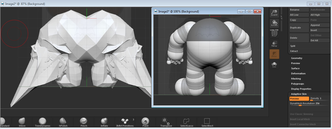

why does the adaptive skin look like this on this zsphere model?
Thanks in advance. George
ZSpheres can be tricky, especially if you are adding many spheres close together. It looks to me as though you have got some spheres inside each other at the elbows. That is going to cause problems. You need to aim for clean joints so you get a clean mesh. Try and move them apart t see if that helps, or delete any spheres that aren’t necessary.
