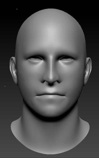

Hello everybody !I am newbie with ZBrush. I started yesterday.I am trying to follow the tutorial about bust sculpting from 3DMotive.I loaded a tool (a face) and reference photos with the Draw command.it’s said in the tutorial not to use Project Save because of big files.So I saved the tool. Then tried to exit ZBrush.Then I’m asked to save the project.If I don’t do it, I lose everything (the model & reference photos).I don’t understand how to save my work without using Saving Project.Thank you very much for your help.ZBrush.jpg<strike></strike>

My scene is made of 2 reference images and the bust.
At present time I saved it as a project but I’m aware that’s not perfect. What should I use if I want to keep everything (images & bust) ?
