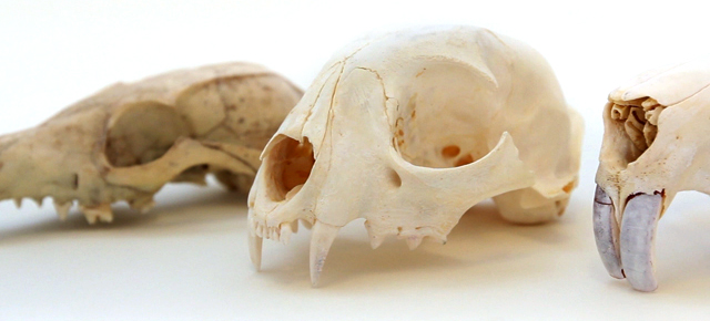

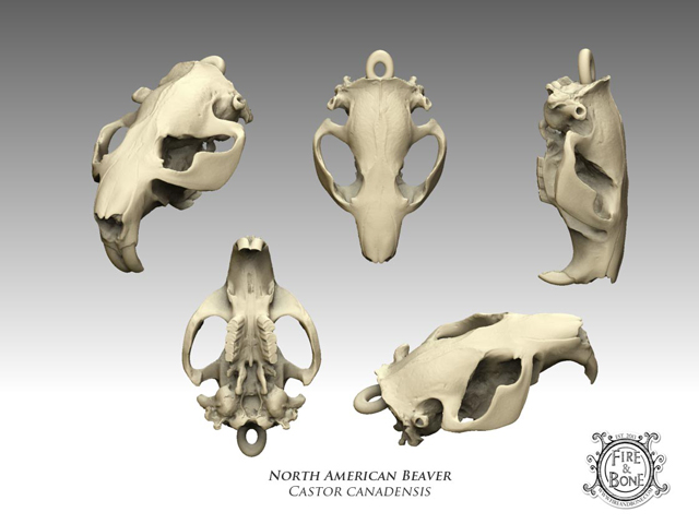

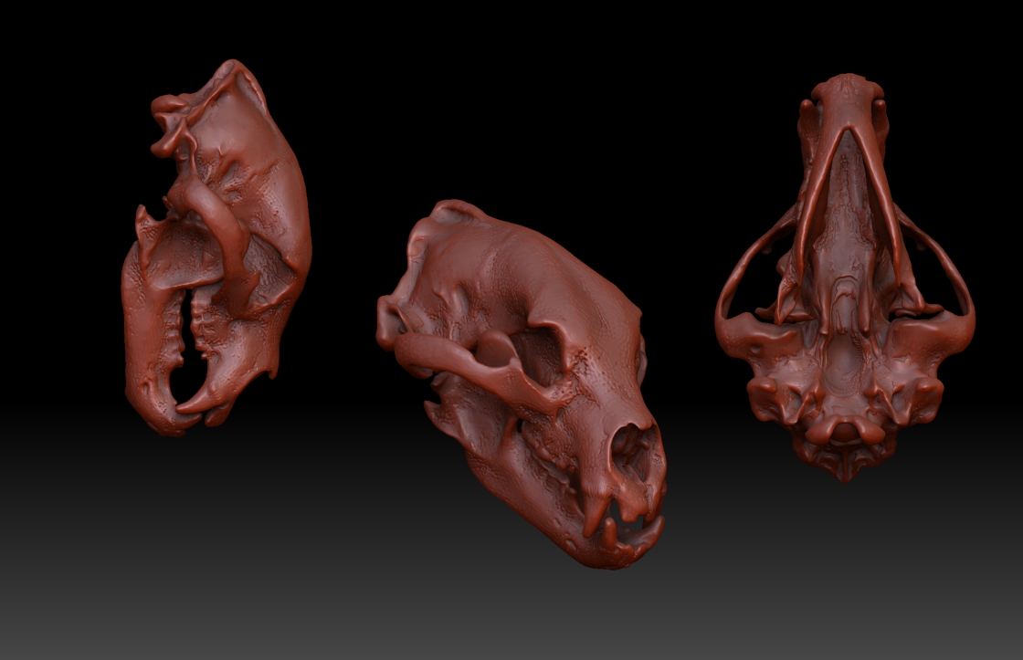

1.) Find an awesome skull
2.) Have it scanned digitally

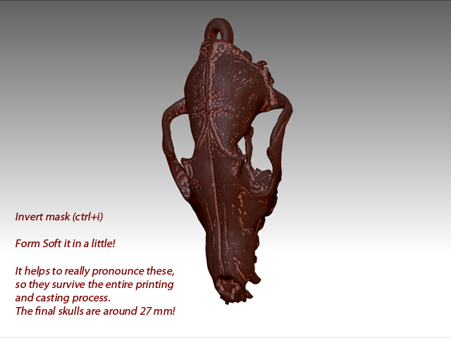

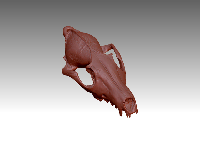

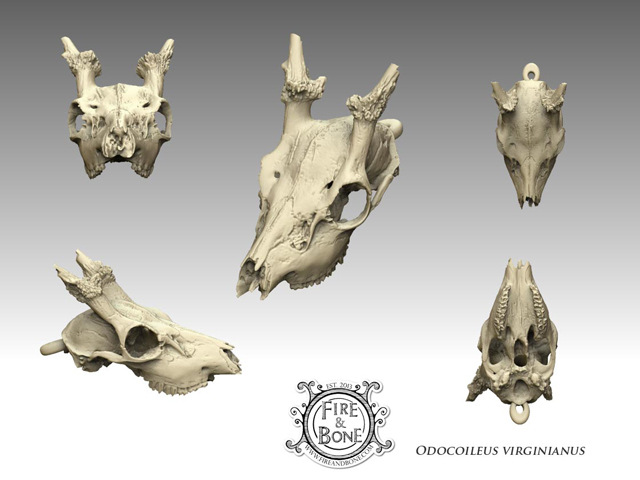

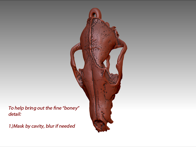

3.) Take that digital mesh, and realize it will never work unless you ZBRUSH it!
4.) There are holes to fill, details to bring out, and sometimes entire areas that need to be re-sculpted. Thank you Pixologic.

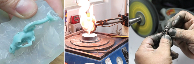

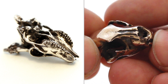

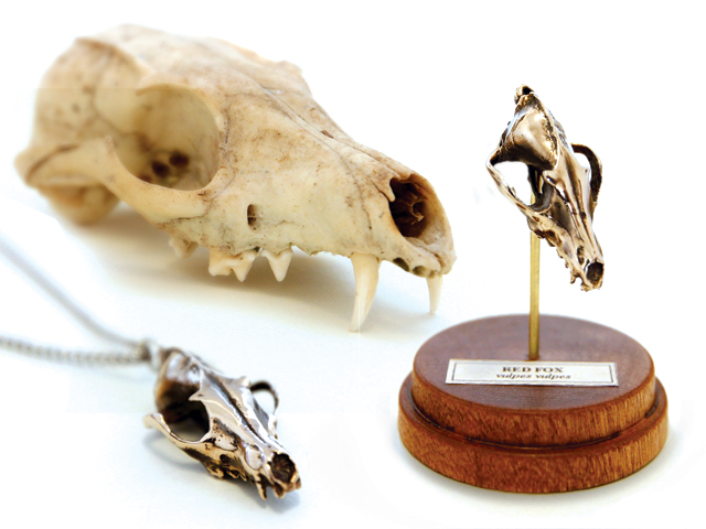

5.) Print the model
6.) Mold the model
7.) Cast the model in wax

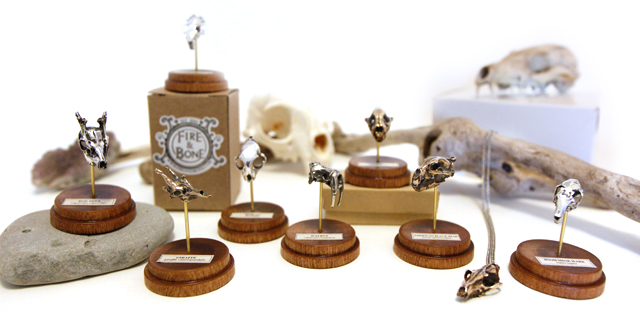

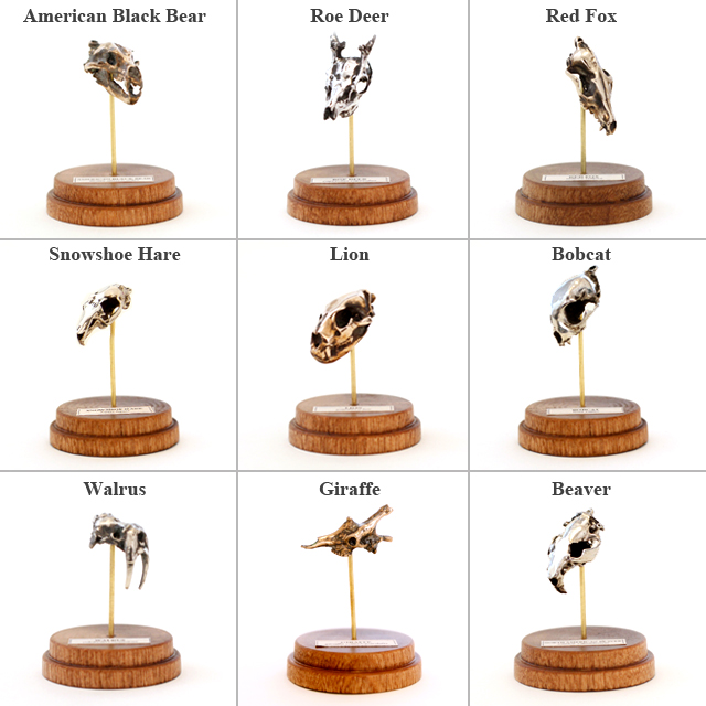

8.) Cast the model in silver, bronze, or even gold!
9.) Sweet.
