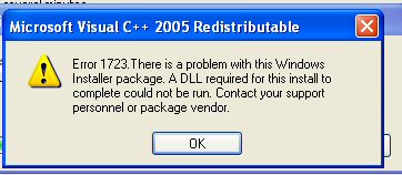

I am getting the same problem on my laptop, the install on the desktop machine was fine. I have uninstalled and reinstalled on the laptop to no avail, tried the the Microsoft exe file in Zbrush 3 troubleshooting folder. It came up with the same error as it did when ZBrush was installing.install error.jpg

Hey Bucky you beat me to it, but I’m going to check your link, because mine is a different .exe
Well that link sorted my problem out so I don’t see any reason it wouldn’t work for others…
Mine is just the installer update though not a service pack, maybe thats the difference…
Dave try the above error 1723 link I posted above it should sort you install problem…

Thanks Buckie that did the trick, hopefully those with other errors will find answers as quick. We have all waited with great anticipation for ZBrush 3; I can understand that it will be frustrating for those that have not been able to try it yet. Not surprising that it was a Microsoft problem, a computer repair guy who did some work for me has a favourite saying, “Windows has detected a slight breeze, Windows will be closing down”. :laughing: :+1:

Thanks Buckie - I’ obviously treading a well-worn path after two abortive download/install attempts. Your Windows Installer patch did the trick and I’m now up and running. Guess I should have checker here first before ordering the back-up CD as well… c’est la vie. Thans again.
