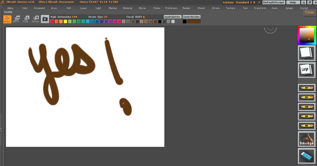

does this script work with the demo ?
Absolutly yes!
