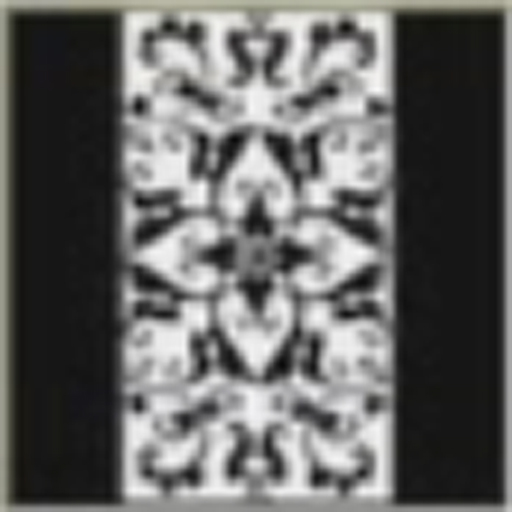

Can you tell me where I can find the alphas used in video 3? (SYDE0114)
Iāve tried searching the internet and canāt find any stencil, pattern, architectural ones.
but if you click on orange line, you can still watch the video. thanks! it was wonderfull!

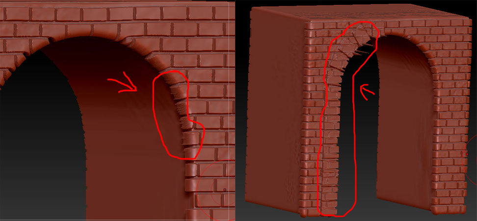

I got some problem, not sure why ⦠Can anybody help me fix those ?
- while using projection, at the edge there is some problem(left image).
- I tried to project like another bigger block on top of the current brick but it seems, also the below part is seen and again same problem in the edges.(right image)
- how to project something in arc uniformly, need to place them manually or some brush stroke is there? like in the āgod of warā sample
thanks

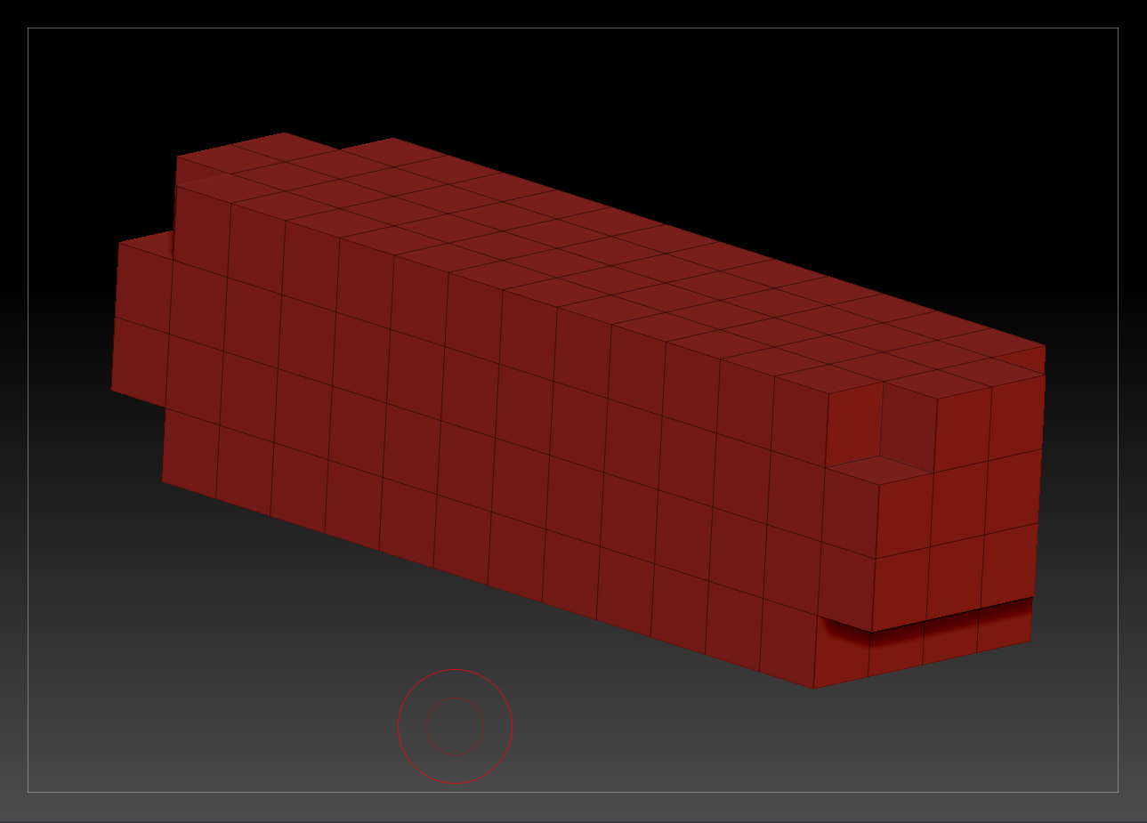

Hello guys, Iām kind of new so i apologies for this. Iām using version 4 and trying to follow the tutorial, but when it comes to the part of applying Unified Skin at the very beginning, the shape of the Skin_Cube3d resultant is not like the one in the video⦠i have read that the options in the Unified Skin menu changed⦠for example, you cannot go down to Resolution 8 like in the video⦠and if i leave it to 16⦠etc⦠so, is thereās a way to following the tutorial with new versions?
This is the error i get⦠i would appreciate any suggestions⦠thanks!
Here is what you need to do to make it the same if you have the latest version, Unified skin> Resolution 32> smooth 0> Geometry> Divide 1 with smt off > divide to 7 with smt on and that will get you the same results as the video. That is the only way I could find⦠Cheers
