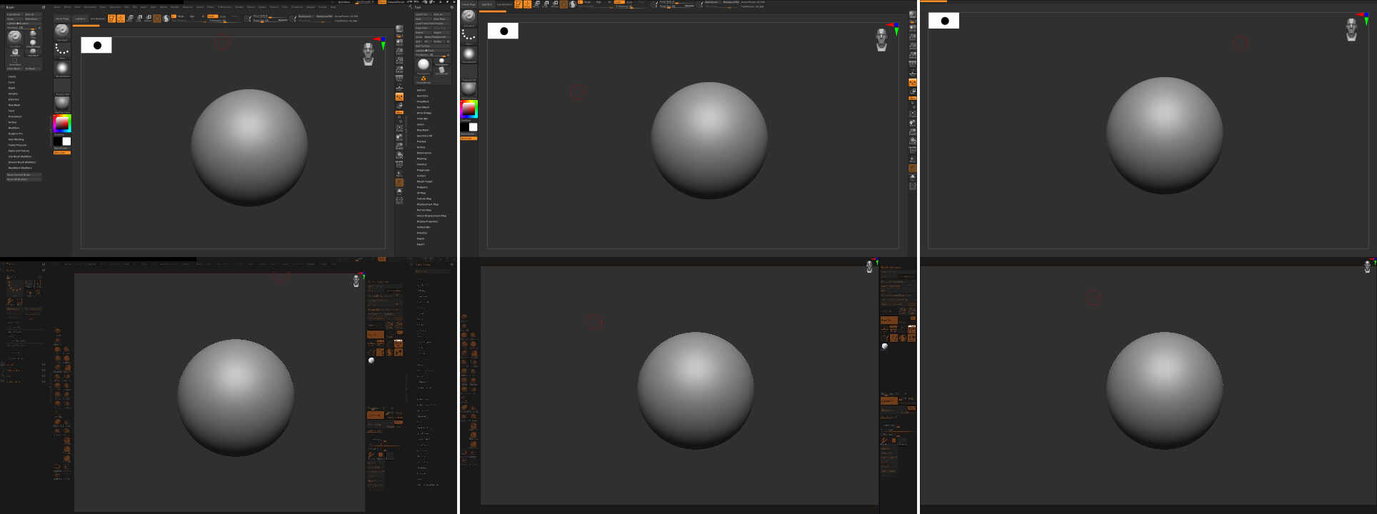

ZFullscreen
Macro that Fullscreen zbrush. Only canvas shown. Hides: Title bar // Side panels+ clickeables (top left right bottom) // Notes top left // Menu bar.
Is a combination of marcus_civis scripts + my code.
Default vs My interface
On my interface i have hidden the rectangle + thumbnail + history bar
To hide the side panels
PREFERENCES > interface >float menu (add shorcut with CTRL + ALT , i use “Tab” for those panels and “CTRL+F” for fullscreen)
To hide white rectangle
PREFERENCES > EDIT > DRAW TRANSFORMATION BORDER
To hide Thumbnail
PREFERENCES > Thumbnail > Thumbnail
To hide history bar
PREFERENCES > Undo history > Show undo selector
Zfullscreen.zip (745 Bytes)
here is the code, just make a .txt file (or place de .txt from zip file)
on Zbrush\ZStartup\Macros\Misc
and then in zbrush  macros ->reload all macros
