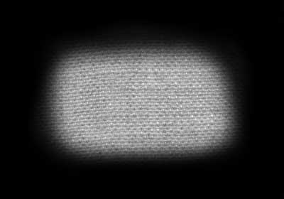

After alot of googling I found a nice pic of actual mummy bandages that I’ve made an alpha for. So at least I know the bandages will have an authentic look to them. I’ve still got to do a texture and probably would have had some of it done tonight but for having some problems texturing in projection master. (It was doing some crazy stretching spotting type of thing)
I want to add a bit more defination to the edges of the bandages using some texturing and maybe some better cavity shading.

hey - cool bandage texture. where did you find that image you made into an alpha too? looks nice.
only comment on the texture work is the distortion in the middle - have you still got the symettry button on? best tuen it off for texturing the little details. nothing is symetrical…except for geometry…and loads of other stuff…:+1:

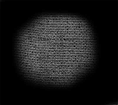

Mummy Cloth#2
Here’s some alphas I’ve been using (and will use) on the model in case anyone has a use for them on their models. I hadn’t noticed the stretching that was due to the angle I was using at the time so I’ll probably have another go at it tonight time allowing.

hey cool. thanks darth! nice little alphas you made up there. ill try em out sometime! :slight_smile:

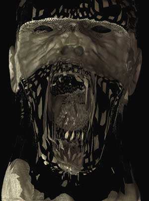

Well it looks like due to my inexperience when I started this model and not really knowing what the hell I was doing and learning as I went. I messed up my UV and a load of other things that haven’t became apparent till now at this late stage. I’ll break with my tradition and put my render’s from tonight below instead of above.
I started to texture further the model, trouble is once I got beyond a certain level of detail everything messed up right royally! It really is a shame because as I dont have the experience to put this right I may have to ditch this model. I’ve learned one helluva lot doing this mummy head but it’s stil a shame I haven’t got to finish him off.

Soon as I tried to start texturing the face and further detail texturing the whole thing goes mental and refuses to texture properly!
Tool > Texture > Check UV. If you get any red showing, you have over-lapping uv’s which will always cause probs in ZB. The probable reason you’ve got an issue, though, is you had a texture map applied when you started pressing the uv mapping buttons in ZB. Go from one type to another, and ZB will still use the texture map as showing in the preview thumbnail. What works for guv tiles, for instance, is gonna look damn weird if you then select spherical mapping (for example). Try going back to whatever uv mapping version you were using originally.

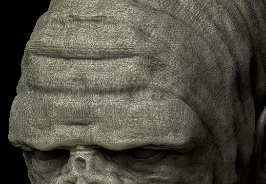

Front view of 1st bandage layer texture…more dirt etc to be added and face still to be done.
Thanks! Although I’d tried this before it worked this time, probably because I was a bit stressed before when I did it. I’ve done the 1st layer of the texture for the bandages and they are starting to take shape a bit.

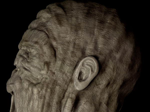

I thought I’d have another mess around with this model. It’s got to the stage where all my early errors made while still learning Zbrush have came and bit me on the backside. I’m looking at Major UV probs (redoing texture and mapping doesn’t seem to help) and if I try to apply another material to the face area it messes up big time. So I thought I’d try a different approach.
What I did was to do two renders each using a different material and composite the face area in Photoshop. Yeah I know it’s cheating but it seems to have worked, meaning I may actually be able to continue with this model.
Wayne…

Some more bits and pieces have been done. Although I’ve had to compromise on the face texturing as this model is screwed, so I’m just trying to get it looking as good as I can before I move onto other ones. I’m pretty damn pleased with the way the bandages have turned out and to my eye the neck area looks pretty damn real. All done by hand no app link, only some color correction (and pasting the face render as outlined above) done to it in photoshop.
I’m starting to notice the limitatins of using a mouse of late, although I do have a ‘no name’ micro small tablet its worse than useless. But looks like I’m sticking with the mouse for a while.
Enjoy
Wayne…

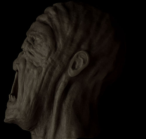

Thought I’d mess around with a nice black and white image…after all most mummy films were made in black and white.:wink: Mind you it also helps to hide the dodgy face texturing lol.:lol: :lol:
Wayne…
Yup … you did good and learned a lot from this piece, I think. And you stuck at it, too. :+1:
