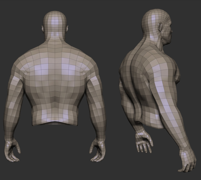

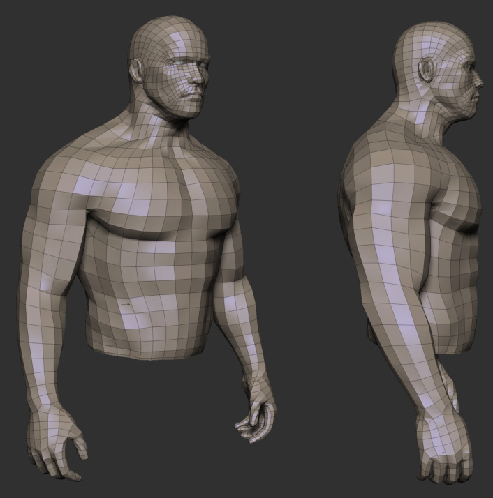

I would love to see a big screenshot of the lowres wireframe of the upper body in different angles.

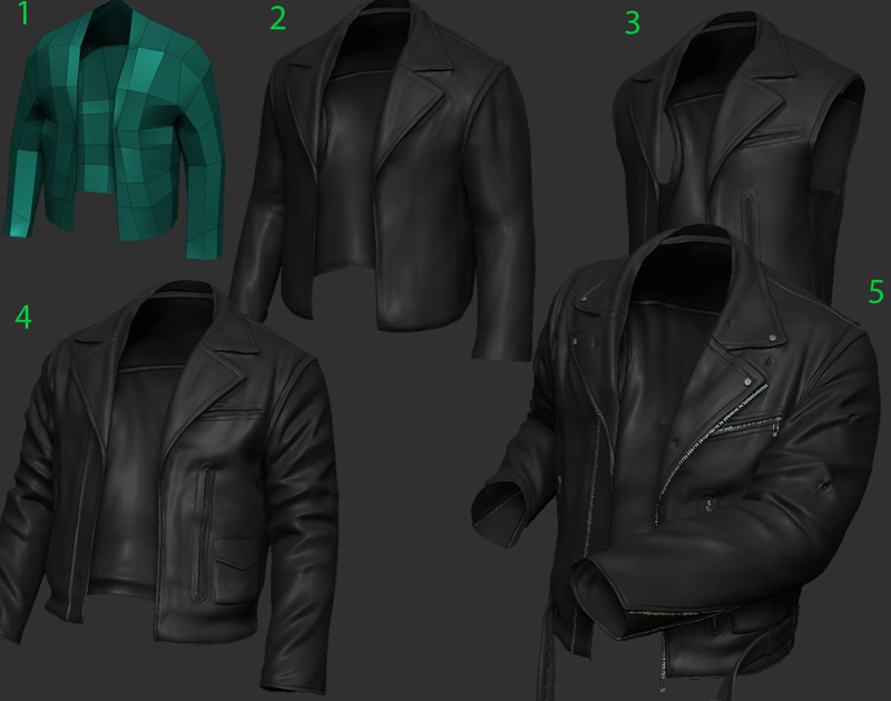

hey Hasnz…thanx man.i had made some really basic steps that i used for the jacket and the hair for my thread on cgtalk.so here you go ill post em here too. hope these are helpful
hey Antropus.thanx buddy here you go…
JACKET:
1. Made a lowpoly model of the jacket around the bodybase mesh in 3dsmax and exported it zbrush
2. Subdivide the mesh and started fixing the proportion of certian things like flaps,collars etc.
3. Adding all the pockets, zipper borders and stitch lines. NO FOLD or WRINKLES ADDED YET.
4. Adding Folds STARTING FORM LOWER SUBDIVS and then going a level up as this defines the base for each subdiv level.Using diff Ref images for each part of the jacket (collars,armpit,back,elbow). the final wrinkles and small folds can be added in the final subdiv level after its starting to look good.
at this point you can add the zippers and belts ie imported form max9 or maya ,or you can do this in the final posing step.i did it before the posing
5. Posing the jacket using Tranposmaster Plugin on zbrushcentral, helps you pose multiple subtools together . some time it doesnt work or crashes,this is mainly due to errors like
a. the lowest subdiv is really high or there are no lower subdiv’s
b. the low subdiv is extracted form another subtool and has uneven borders(will explain in the Hair Part)
c. mesh containing Triangles
d. some times even renaiming the subtool fixes this .
hope this has been helpful to some.will post the Hair part soon too.thanx

This is fantastic, the likeness is uncanny. My only crit is on your topology. To make this guy riggable you should have three edgeloops at any joint that needs the bend; so knees, ankles, elbows, wrists, knuckles. Also the topology at the wrists could be cleaner. You have a diamond right where bending needs to occure.
A tip, if I may. One way to avoid those pesky diamonds in the future is to start repologizing from the most extreme appendages (tips of fingers and toes) and work your way in, linearly, toward the shoulder and hips. That way you know you have all the geometry you need for the hands and feet, and you don’t have to do any funky poly-doctoring to make it match up.
