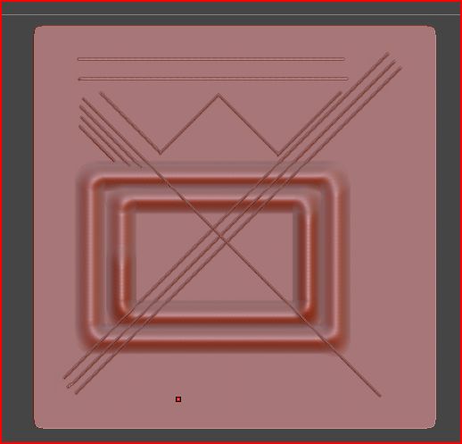

inorder to draw straight lines(horizontal, vertical or 45 diagonal) in zbrush canvas without going into projection master, hold down the shift key after you draw, not before. This will result in the startting bit of the line not quite perfect, but is the closest way I can get around to do stright line drawing.
Actually you do not have to even start a line. What you do is hold down your left mouse button, but do not move it, then press shift, then move your mouse while holding down the left mouse button, that will make you a perfectly straight line from start to finish, no ugly starter lines need apply. :slight_smile: hope that helps for anyone who comes across this thread topic.
well thanks a lot sgtkoolaid that’s an excellent tip to know.
I tried it out :slight_smile:
I know this is an old thread but I would like to ask if is there a better way to do those lines , especially how to do them in masking , as seems work only outof masking and also the problem is you cannot decie the direction befoure starting drawind and most of the time I can’t get the right angle to start the line …
