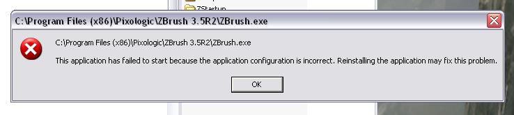

To be safe, it is best to treat all folder names as case sensitive.
: My appologies, should read more carefully
Oki so I did all the steps and read all carefully. Still I only got this?!
Running:
Win XP X64
8 Gb Ram
Intel Quad 2,8
ATI Radeon 4870x2
Best.

Have you run the C++ installer in the Troubleshoot Help folder? Have you tried disabling DEP for ZBrush? (see the text file in the Troubleshoot Help folder) Are you setting ZBrush to run as administrator?
Does your ZBrush 3.5R2 folder have a subfolder called vmem? Does your ZStartup folder have a subfolder called TempFiles? If not, create them.
Have you tried reinstalling ZBrush? And is the folder named ZBrush 3.5R2 or just ZBrush 3.5?

Yes, I ran the installer, disabled DEP for ZBrush and tried running it as regular user and as Administrator. No luck either way.
Steffen
